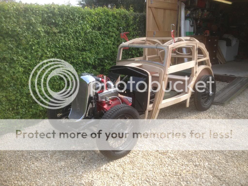

PostPosted: Sun May 11, 2014 9:08 pm    Post subject: Reply with quote
Out in the sunshine to see how she is shaping up and take a good look round her. Only seeing the frame up close in the confines of the workshop means that one never really knows how it looks so this was a bit overdue. Not too bad, one or two areas that could be better but generally pretty good. The advantage of building a version of a car of which no examples exist is that no-one can tell you you've got it wrong!! Doors still to complete and the sliding roof to tackle but am consulting the metal fabricators soon to check that I am doing everything that they need in order to get the skin on.
