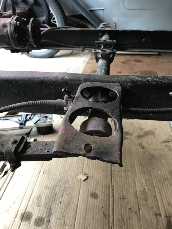

Now the body has been removed I can get on with restoring the chassis. I am a bit concerned that the n/s chassis rail seems to be slightly bent downwards at the back. Whether this will affect the car's handling/steering I don't know but I envisage a slight problem when it comes to fitting the new body.
Some bright spark has welded the handbrake cross tube (two cables) in the wrong position. I am not quite sure how best to correct it?

In your photo Ray it looks like the section beyond the rear spring / cross member is slightly bent inwards rather than downwards.
Cut loose and weld to the correct position. Or is that too simple.
No, fortunately it is just the photo. Both rails seem straight enough.
Also, there seems to be a slight natural dip under the axle so it is probably correct.
There is some damage to the o/s outrigger and the n/s one seems to have been repaired at some time.
I think it depends on how far the weld has penetrated. If it has gone into the outer collar too far I will have to remove the rivets from the
chassis both sides and extract the cross tube. I may have to do this anyway as I don't like the amount of play in the bearings. As you can see when the tube rotates it pulls on the cable which has already gone way past it's optimum leverage point and is at the very end of it's adjustment.
Then again, it's only a hand brake so as long as it works I am probably being too precious.

Things are sometimes not what you think. Looking at the handbrake cross tube it dawned on me that the adjuster didn't look right. It wasn't. Helpful Henry had cobbled it together with an off cut of copper tubing and a nut with an incorrect thread forced onto the end. With a bit of thought he could have done something similar to my solution. A shorter spacer and a wing nut will now allow me to correctly adjust the cables.
The handle is a bit wobbly and could do with new bushes but that's not a priority just now.
