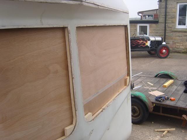

all done at the bottom. moved up to the windows.
i had to remove the wallboard that was glued around the window edge as some was rotted, i dont have enough wall board to match round this area so im covering the area with new plywood then covering it with some canvas ive picked up from a picture framers. this will be glued to the ply and painted when finished, it should blend in with the roof panals.... i hope
here is the ply fitted in place ready to have the window openings cut out
just need some small sections of wall board to match down the sides of the van were it meets the front panal. then recover the window sill and put all the hardwood trim bits back on the edges.... after fitting the window though.
coming along, think its going to work out fine!!! |

here we go again....
cut window openings out and trimmed corner blocks, fitted capping and then it started to rain so up went the blue tarp as im doing all this out in the open........ i spy my little hotrod in the back ground
once the rain stopped in went the windows and awning/drip rails
still got to finish the side panals where it meets the front, but ill have to find some matching wall board from somewhere.
