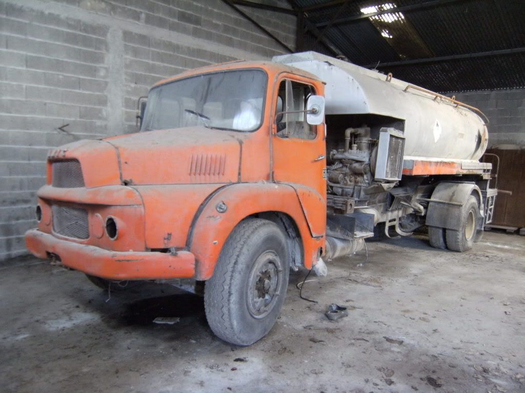

I came across this the other day. I am still trying to contact the owners.
It is 1964 6 cyl 8 Litres with eight forward gears. I believe it is the model called Esterel.

Wow that's quite a machine isn't it, I bet the mileage is tiny.

You are dead right there, Rick. The mileage on the tacho is 53662 KM
(about 36,000 miles)
The diesel engine that drives the air pump for the tar heating looks good too. It also drives the tar pump.
The only things missing are the brakes compressor and the dash panel.
I think I would convert it to a beaver tail transporter as the chassis is so long.

Now thats one BIG "toy" Cool looks like it has been kept in a good dry place.

The Esterel was the cabover type.This is an Izoard.
I hope this one was more reliable than the Esterel,they were hopeless.

This is deffo an Esterel as the model number is MZ125. The Esterel with the cab over is a MZ124
The Izoard (MZ221) is 8 cylinders and has a longer bonnet.
The Izoard with the cab over is the MZ222
They all suffered from chronic under power until the V8 and V6 with turbo was introduced.
