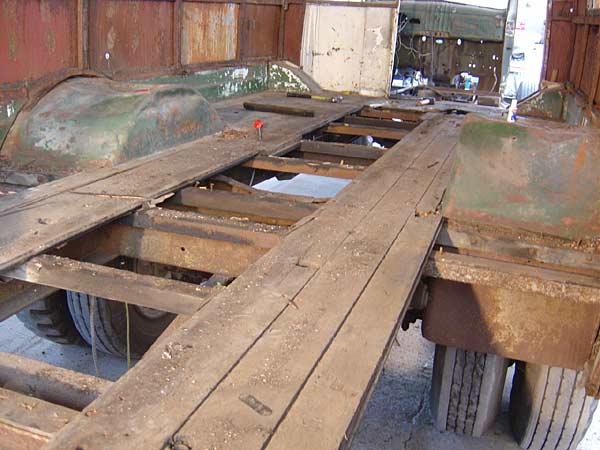

Had a call from the resto place today, they told me that the floorboards aren't coming out to well and that I should come and have a look. Basically the wooden planks have deteriorated and show signs of woodworm here n there, and some are oil-soaked and in poor shape. Plus when they are coming out, some are splitting etc. The millions of small screws holding it in are putting up a fight too, so they asked if I'd be ok with the floor being replaced with identical looking material, sourced from a reclamation yard.
Ideally I'd prefer to keep the original and treat it where necessary, but the time (and cost) of trying to pull it up properly, with no guarantees that what comes out will actually be usable, means that I think I'll have to go with what they suggest, ah well!
The important bits of wood, that were haphazardly nailed in the back in order that a DB3 Aston could be carried in it back in the 50s, have come out ok and will be returned to their original positions once the main flooring has been replaced.

PostPosted: Tue May 01, 2007 5:50 pm    Post subject: Reply with quote
I have just got back from the resto place, all of the flooring is out now, I only called in quickly, but I did spend a few hours last week carefully removing the screwes, or some of them, and it was very hard going!

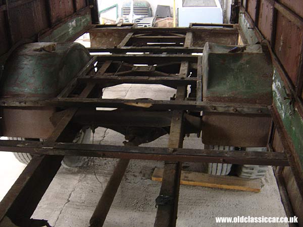

PostPosted: Fri May 04, 2007 7:24 pm    Post subject: Reply with quote
Popped in today for a quick look at the back, with all the floor out
Hope is to get the engine and box lifted out (with a HIAB) next Tuesday, so will try and bobble over to see how it came out! Smile
PostPosted: Fri May 04, 2007 11:20 pm    Post subject: Reply with quote
Looks big inside now with all of the wood removed!
