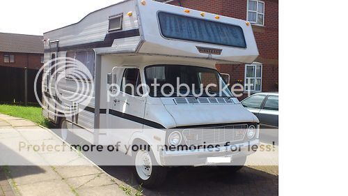

As Carol and I are thinking about having longer trips away at vintage shows (and visiting those more than 100 miles from us, maximum I'll go in a day in the chevy) we've recently purchased a 1972 Minnie Winnie, no interior but very solid - and cheap!

Hi in the East. Not familiar with these engines but if you look where the two pipes come down just behind the water pump,then to the right of the smaller one, there is a small flat area with what looks like a temp sender screwed in - removal of this item would confirm if there is a bulb end to it. Like the look of your Winnebago,cheers,JD. _________________ 1958 Ford Zephyr Mk2 Convertible
