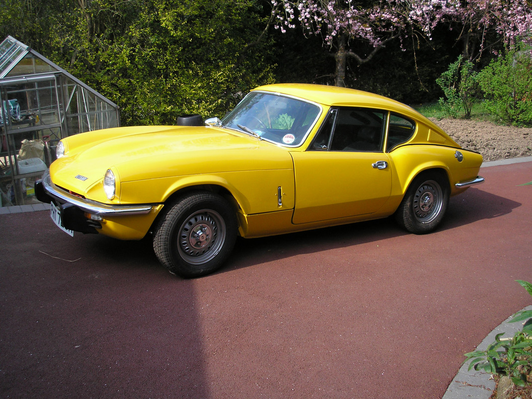

That said, Herald era Triumphs are temples to iron oxide. I'm yet to see a Herald, GT6, or similar that hasn't got rust problems in the floors, arches, valances, gutters, and windscreen surround. The obvious exception being those cars that have been meticulously restored, of course.
No longer in my possession but this Mk3 GT6 was my daily driver for over 30 years. Regular dousing with wax oil kept the chassis and floor rust free and when I restored it all I did was replace the cills, front quarter valances and lower front wings. The front of the roof and windscreen pillars are the most tricky rust traps.
