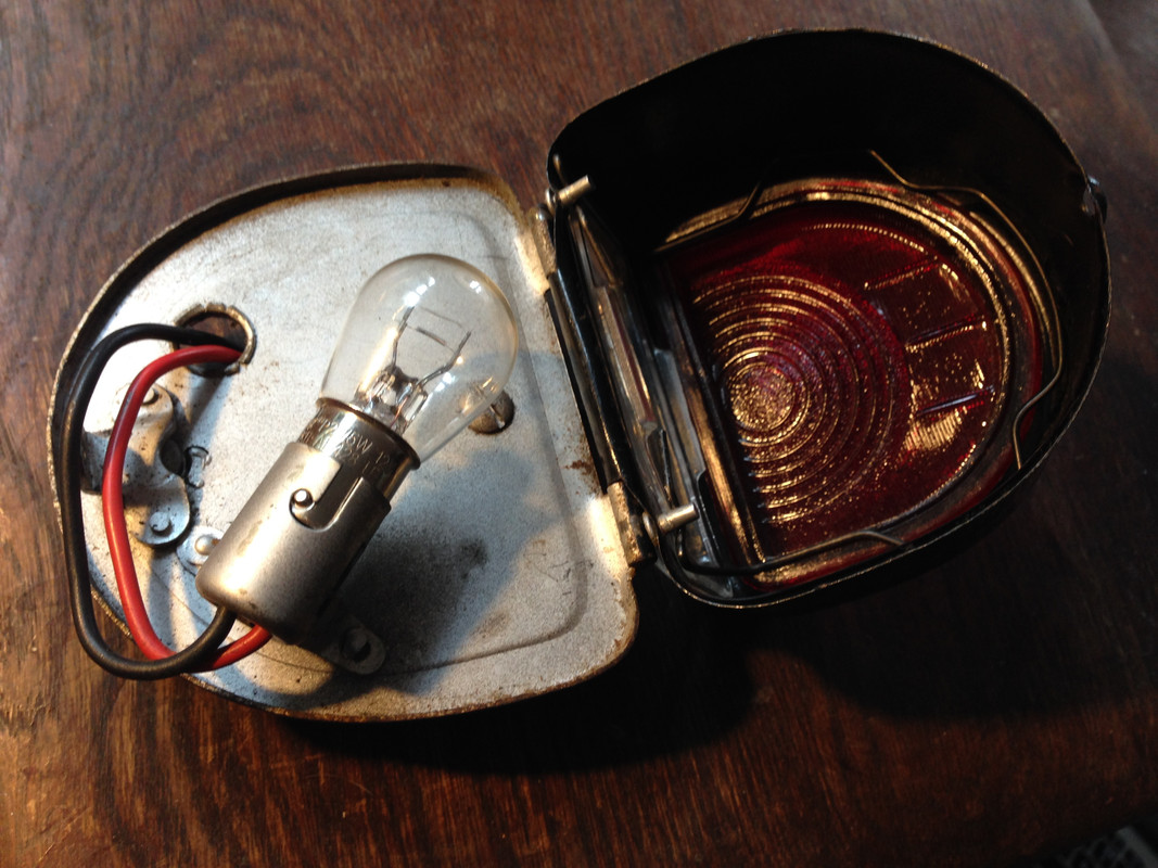

Posts: 2759
PostPosted: Wed Jun 12, 2019 1:19 pm    Post subject: Reply with quote
A photo of my D lamp. It is apparent that I would need to reposition the bulb holder to fit a divider. No problem.
