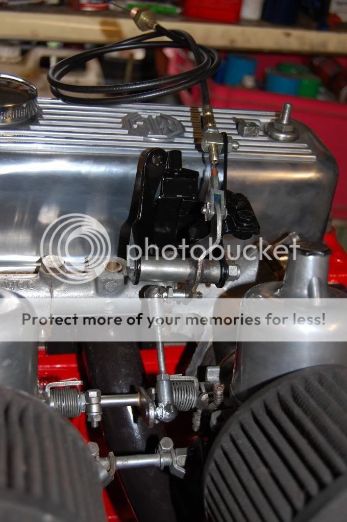

The automatic box (underneath the engine) was never fitted to the B with these carbs and the linkage does not fit so a bit of fettling was called for.
And the linkage in place and working.
