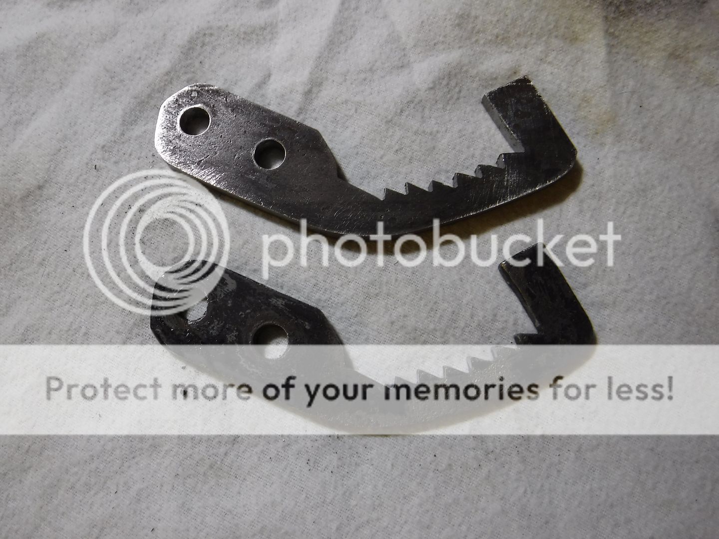

Anyway, all looked good until it came to pulling the brake on and I realised I had no ratchet gate to keep it on!
A quick visit to the underbelly of the Aero tourer revealed the required part so I whipped it off and set to thinking about copying it.
I first selected a likely looking piece of scrap steel and clamping the old one to it, drilled corresponding holes and bolted the two pieces together. I then roughed out the new one by carefully carving around the pattern with a 4" grinder and thin disc, finishing the edge with bench grinder and files. This was relatively easy but the tricky bit was to come, how to make the 'teeth' of the ratchet. I thought of ploughing straight on with the files but slightly lacking the confidence that this was the best way to go, I put everything away and shut the door.
The following day I reviewed the job and decided that as long as I was very careful not to damage the pattern (which was already understandably less than perfect with the wear of eighty years plus) I could file the shape required.
An hour's work, filing, checking, filing and checking again produced a fairly satisfactory result which worked very well when trial fitted and tested.
As usual I got carried away with the process and forgot to take photos of each stage but here are 'before' and 'after' shots
It did occur to me though that such a part, coming under constant wear, should be hardened in some way. Does anyone have any views on this please?

Looks like a very good copy. I doubt that you will need to harden it.

Thanks Peter, I'll paint it and stick it on. Another thing ticked off the list

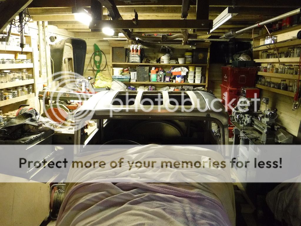

I was determined to do at least some part of the body and planned all along to have a go at the sliding roof. With the help of a small number of people, particularly Lew, the US owner of an MG airline with a similar roof I was able to ascertain how I was going to do it. Basically a wooden framework with a metal skin. Again the frame was ash with the curved sections cut out on my little but brilliant Record bandsaw. Simple glued halving joints sufficed to create the shape and with a deal more sanding and planing than I had planned (made it too thick) the final shape was achieved.
The rebates for the perspex or acrylic panels were also routed out at this stage
I then made a square frame to create the edge round which to form the skin and set it into a shallow rebate made with a hand held small router. The 'ring beam' was then glued and pinned into place with the added precaution of screws in teh corners - I do not want the subframe lifting at some future date.
I then cut out the top skin and have so far dressed the edges to 90 degrees in preparation for turning over to trap it onto the lip.
The three apertures were cut out with a jigsaw and the edges trued up with files.
Next is dressing the edges and hope for the best.

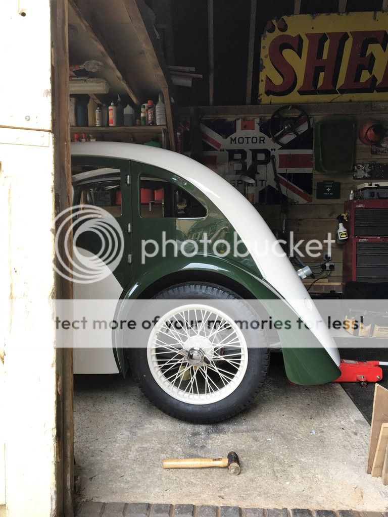

She is now finally back from the paint shop. Quite why they kept her for so very long I have no idea but nevertheless I am very pleased with the results. As usual we were in a hurry when she was returned so no time for a proper photo session but a couple of snaps anyway. Electrics have been resumed and windows and rubbers have been fitted. Some shiny bits are back on and I will wheel her out for some better pictures as soon as the sun returns.

I was just thinking the other night about this project.
How fantastic does it look!!
well done with the project
