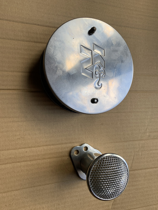

The intake trumpet has a rather coarse gauze which in terms of filtration is about as much use as a cat flap in a submarine.
On the other hand, the lovely K&N filter is causing too much of a restriction and enriching the mixture beyond control.

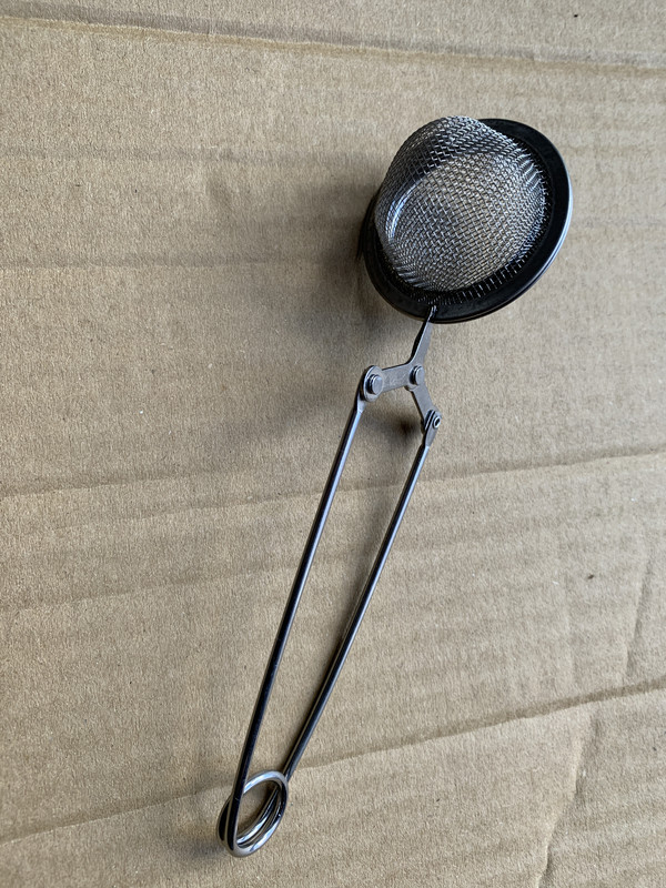

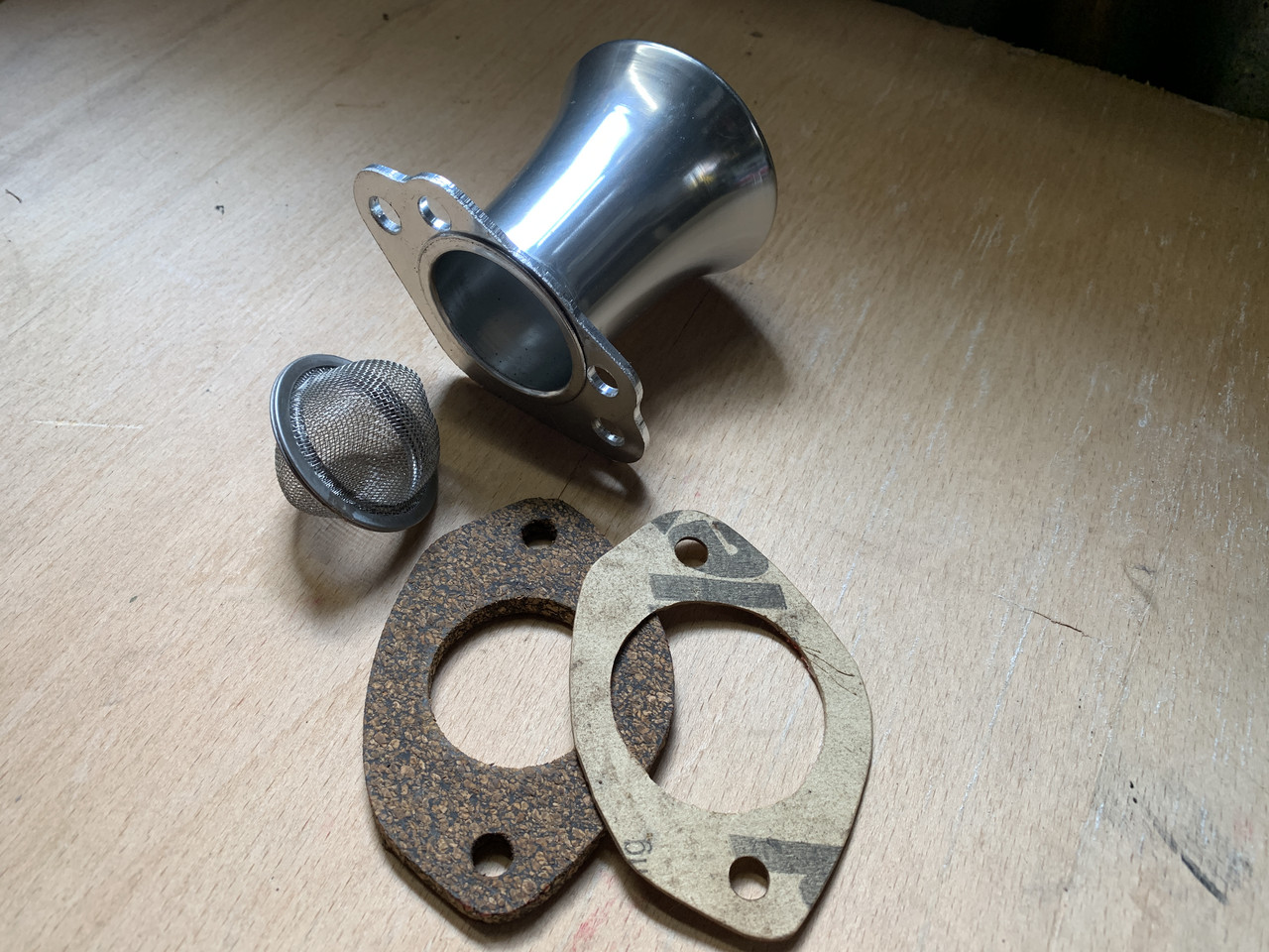

I thought perhaps I could find middle ground by making my own gauze filter from this.!!....
With a little fettling and gasket making this is what I have contrived...
Posts: 2191
PostPosted: Fri May 08, 2026 11:48 am    Post subject: Reply with quote
Looks good. Old fashioned tea strainers are useful...
SU's need [like many other types of carb] a 'stand-off' area in front of the intake.
Haircooled VWs have the same issue with their single carbs.....folks shoved posh pancake filters on top, and had a reet issue with fuelling as a result.
A good inch or two from the face of the carb was, I think, the recommended stand-off distance?
On my Dellow I use [what it came with] some dome shaped filters, which are open...[I found those foam filters sold for Harley Davidsons to be the cheapest replacement foam filters]...all the way around, with nothing solid on the outer sides.

Thank you Alastair. I thought about one of those "sock" filters over the trumpet but decided against purely for aesthetic reasons. I am also not sure how much difference they would make over the K&N. There is practically no resistance with my tea strainer fix but hopefully enough of a barrier to stop harmful bits getting into the supercharger.
Every new idea with this car is up for grabs so I am just experimenting at the moment. Fortunately, I didn't pay much for the K&N filter.
