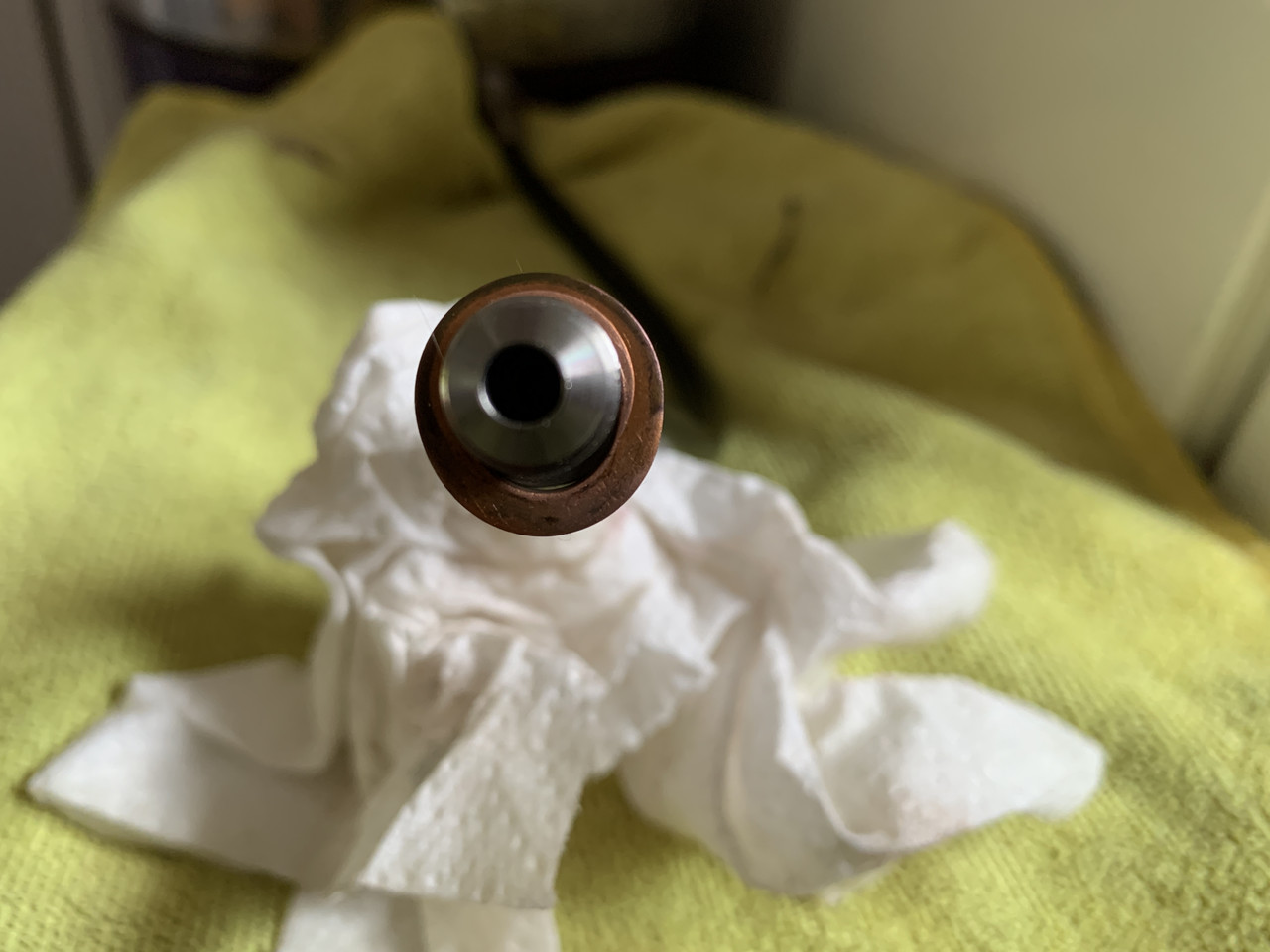

I have discovered why I keep getting air in the brakes. The problem is a poor quality flexible hose; or more specifically, the union with the wheel cylinder. The photo shows how a copper washer has distorted on tightening resulting in a leak. The problem is that the hose came without a sealing washer and if I remember correctly, I thought I could add a copper washer of my own.
The problem is that the plain section of the fitting beyond the threads is of a smaller diameter; resulting in an ill fitting washer. It is this washer that has distorted on tightening.
Ideally, the hose fitting would have had a non removable correctly sized sealing washer but it is not present on these hoses.
A spot of soft solder to the gap around the inside edge of a new copper washer - and filed flat- should enable it to seal safely.

The washer looks to be a tad too large?, I have had this problem when fitting a "close" size metric washer to an imperial thread. The washer should have a similar internal diameter as a nut so that it "screws" on to the fitting and then has just a little slack when its past the threaded part of the fitting. You can always add a thread sealant for a belt and braces job.
Posts: 7452
PostPosted: Tue May 12, 2026 9:55 am    Post subject: Reply with quote
The washer has stretched and distorted out of shape on tightening.
It originally screwed on the threads but the non threaded area is a significantly smaller diameter.
Ideally, the hose should have had a correctly sized washer when it was made...but it had none at all.
I will try again but this time make certain that its remains central.

I have fixed the leak and have a good brake pedal.
