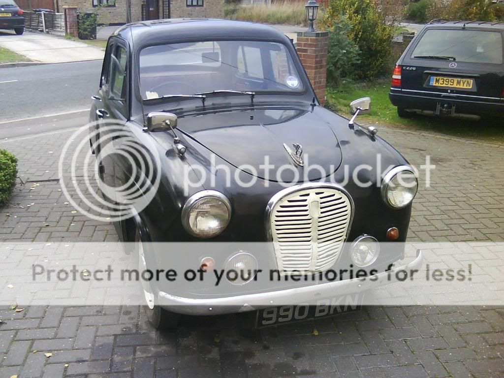

Yesterday I was idly browsing the A30/A35 Owners Club website when I saw a load of A35 parts free to good home. So I went down to Bexley today, and came back with loads of great parts, a mixture of new, new old stock and good secondhand items which I am very pleased with. There are rare parts such as an original grill muff, recon carb, BMC inner sill panel, boot hinges, new gear gaitor, window glass, distributors, master cylinder, new pedal rubbers, indictor lenses, and loads of other stuff Very Happy
And the Black Pig with its proud owner Smile
Note the bent bumper caused by towing - if anyone has a pair of decent saloon bumpers I would like to hear from them.

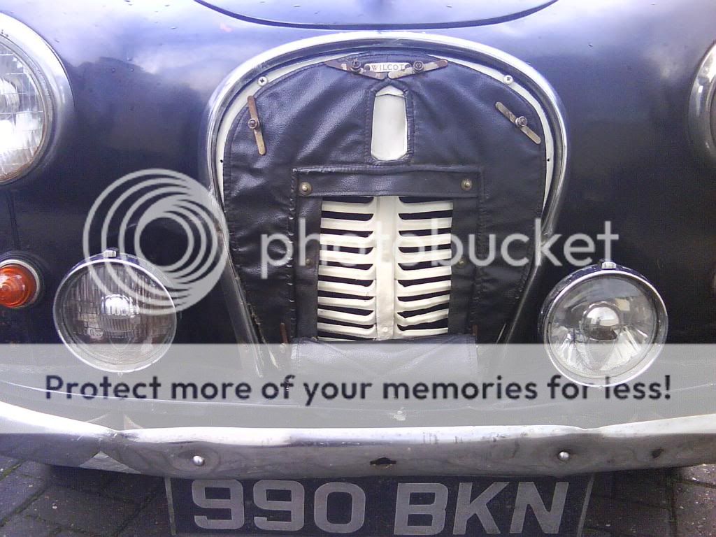

PostPosted: Mon Nov 23, 2009 1:22 pm    Post subject: Reply with quote
Got the spotlights working Smile
And changed the horrible plastic indicator lenses for the proper glass ones, these came with the free spares. I also replaced the split gear gaitor for the new one, and changed the pedal rubbers for new ones, the originals had completely disintigrated.
Before
After
Tried the period radiator muff for size, unfortunately it ran a little hot with it fitted despite being open, so I think I'll sell it and use the money to get a decent grill for the car instead Sad
