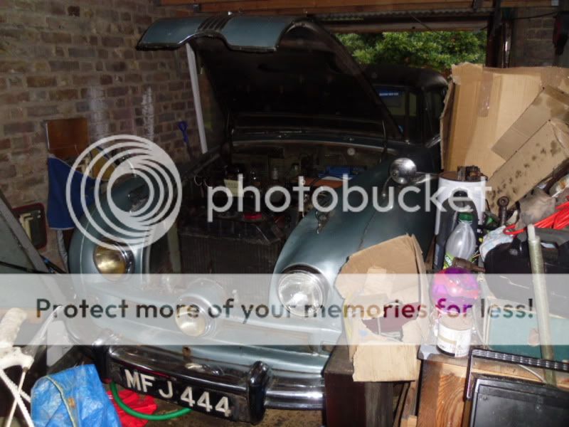

When we got this car last year, it came with a crisp MOT failure sheet.
The main problem was the brakes. The handbrake had been left on for the 36 years the A90 had been standing in the garage, so the mechanics had a bit of a war to free the brakes before it could even be dragged onto the trailer! The clutch was also stuck apparently, which necessitated the removal of the gearbox to free things up.
When we got it the brakes were pulling to one side and very spongy. Three of the front wheel cylinders were found to be seized, which needed plenty of penetrating oil to free them. After at least three attempts at bleeding (made more difficult by the fact that the reservoir cap had rusted on) we eventually got a satisfactory pedal. I must say at this point the intention was to get the car through an MOT quickly, with the major restoration coming later.
The windscreen washers were a problem. It had some kind of vacuum system fitted which had long since 'failed to proceed' and the washer bottle was an old sweet jar which promptly broke as soon as it was removed. After a bit of head-scratching we found something to do the job, coupled with a £10 electric washer motor and switch from the local spares shop and we were ready to go!
I am pleased to report that on the 26th July 2011, the Atlantic passed it's first MOT in 36 years.
After a trip to Chelmsford DVLA for the tax disc (not in the A90!), to celebrate we took it for a quick run, it's very comfortable as a passenger.
We stopped at a nature reserve for some photos.
Action shot!
Unfortunately, soon after getting back from this run the brake master cylinder failed, so since then it's been parked in the garage waiting for repairs. I managed to pick up a repair kit at Battlesbridge, so soon it'll be extracted and we'll start doing the jobs it needs.
As well as the brakes, the battery isn't charging, so we need to investigate that, and the radiator needs recoring as it gets hot if driven more than a few miles. And the large hole in the drivers floorpan needs welding up, and I need to check the sizes of the rear tyres as it is virtually impossible to get the rear wheels on and off, even with the spats removed. Some damage has been caused to the bodywork above the wheels due to forcing wheels on and off over the years. I suspect the current tyres are slightly too wide. The gearchange is rubbish, really difficult to select any gears, especially first, which is really noisy. Unfortunately the A90 is so high geared it struggles pulling away in second. The steering box has several inches of play and is both extremely heavy and has a horrible notchy action. (May just need oil). Also, further investigation reveals this car has been in a fairly major accident at some time. The front N/S wing has been shoved back 1/2" or so and caused a bad door gap where the wing meets the door. There is also some very poor panel beating and plenty of filler around the headlight and front valance. Funnily enough, the main giveaway is the replacement headlight on that side, where the other two have yellowed this one is still white!
