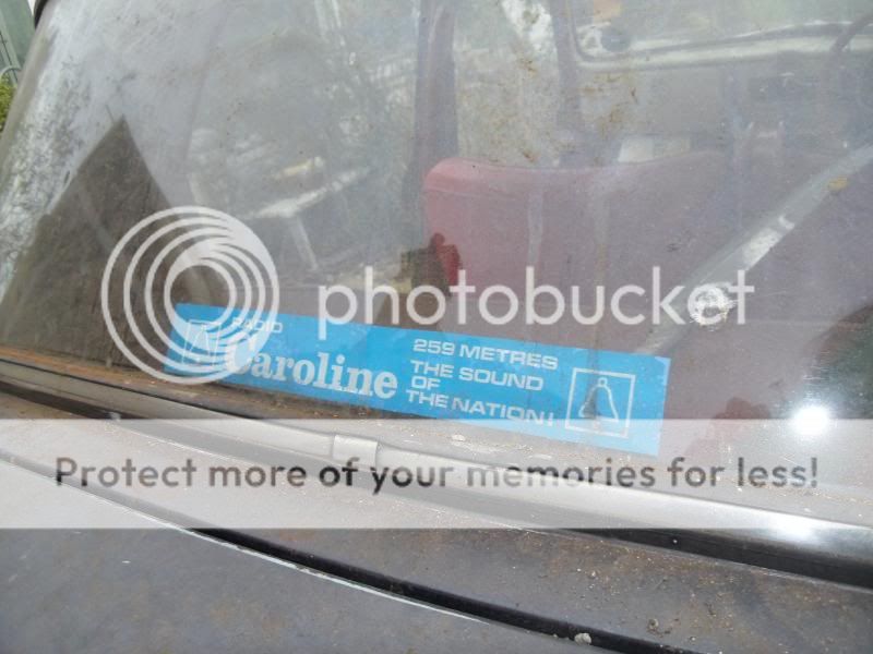

Coming along great Richard.
At least the glass will still be original

Roger-hatchy wrote: | Coming along great Richard.
Roger |
I've got a new windscreen on the way, and a better secondhand set of doors that have windows already in them. The rear screen is the original - unless I can find a better one _________________ Richard Hughes |
