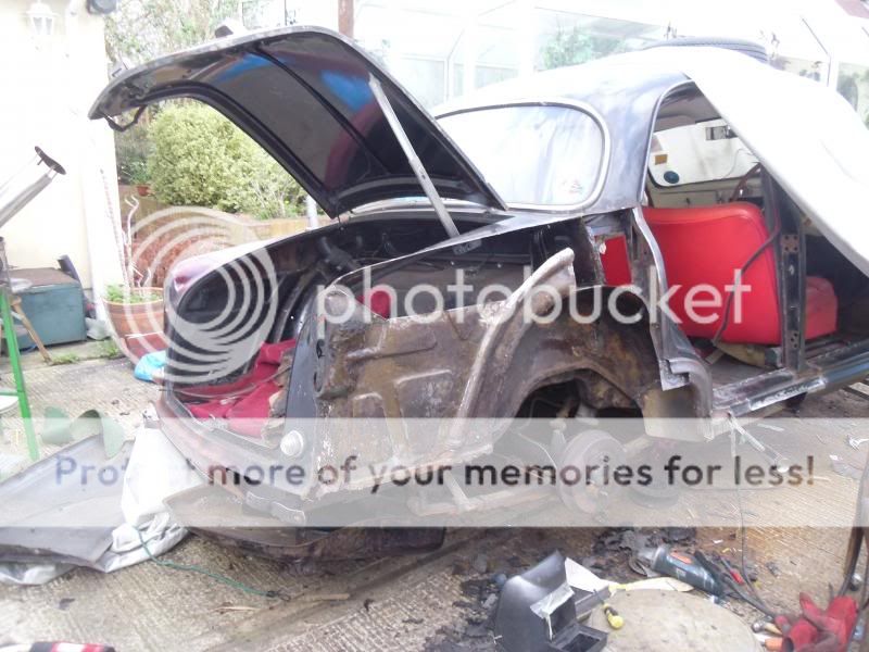

Well I think last update the rear chassis looked like this. As I have discovered, not only has this car had loads of welding before, but it's all patched/plated over rust, so EVERY bit of previous welding is coming out. You may be interested to know that if two, small patches were added this car could have passed an MOT in 2011 when I took it off the road Shocked The MoT regulations on corrosion are very soft really, as long as the patch is seam welded and not about to drop off it will pass, regardless of the structural strength it offers.
First job was to cut off the old outer sill, then assess the rot.
Yup, pretty crusty in there, no surprise really.
This was a surprise though. That's the top of the wheelarch, behind the back seat. The other side was actually solid here!
Anyway, as the new inner sill hasn't arrived yet I set about replacing the rear floorpan.
As you can see I had to cut past the spring hanger to remove all the plates and grot.
Once that was in, I started to build the chassis leg.
I splashed loads of weld-thru primer inside the leg before welding it up.
Tacked
Seam welded.
And cleaned off with the flap wheel.
I then made up the rear outrigger, and got that welded in.
At this point I had a look inside the car Embarassed
Yep, that's the big hole visible from inside the wheelarch, hmm crusty Rolling Eyes
There was also this..
And this, which is part of the rear inner wing. Again, the other side was a bit better in this area.
Anyway I made a start on welding up the wheelarch before I got cold and called it a day.
