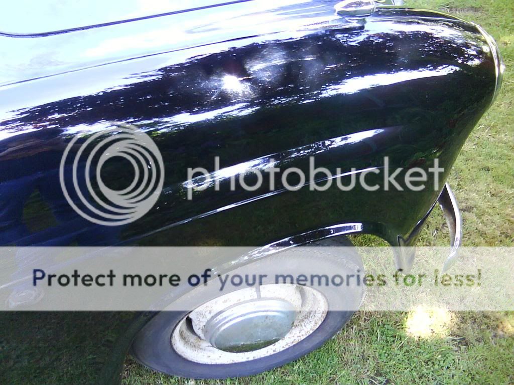

Been doing some polishing, we have now decided to keep the paintwork original apart from a couple of bits, one of which is the wing mentioned before, and the n/s/f wing needs a repair at the bottom, after which it will have to be painted.

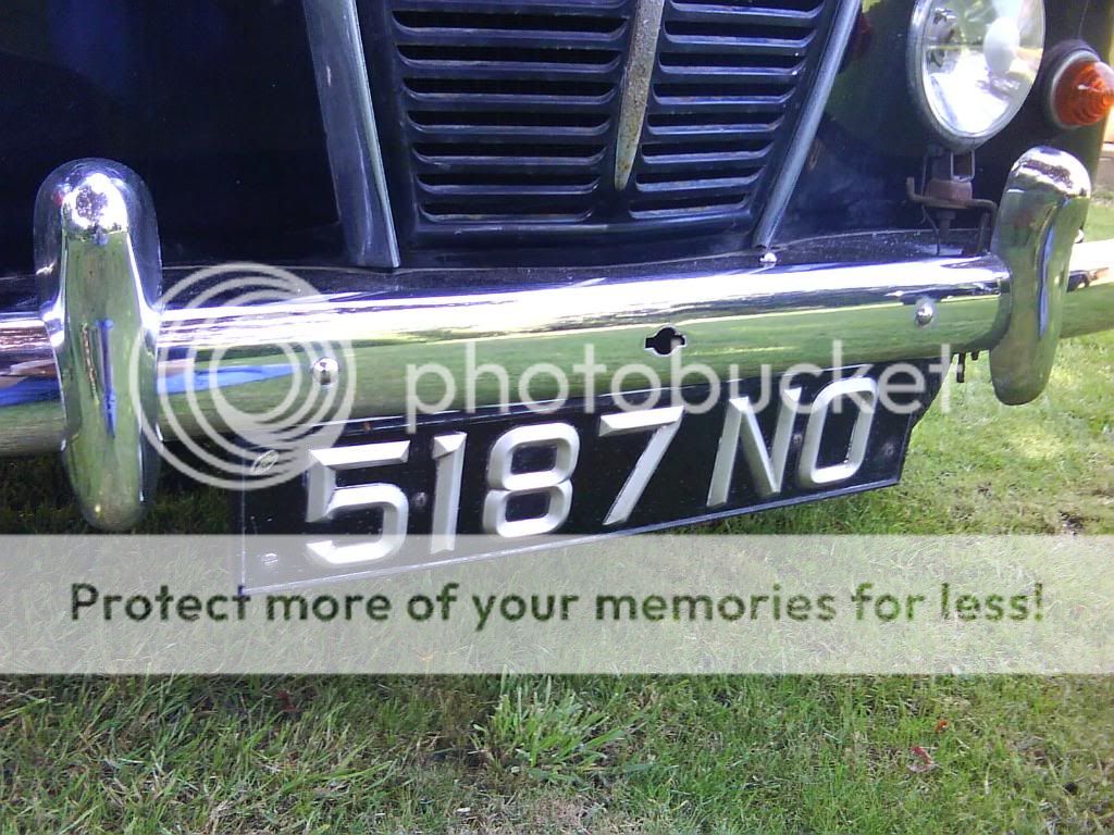

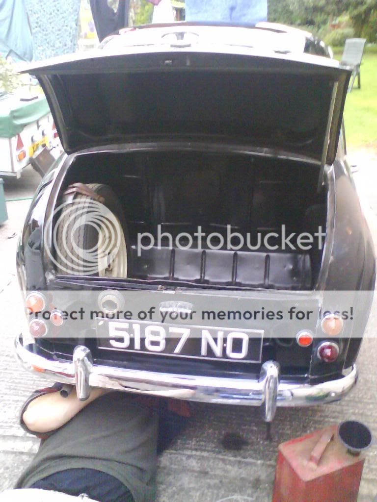

Front bumper and numberplate polished up a treat
Coming up well

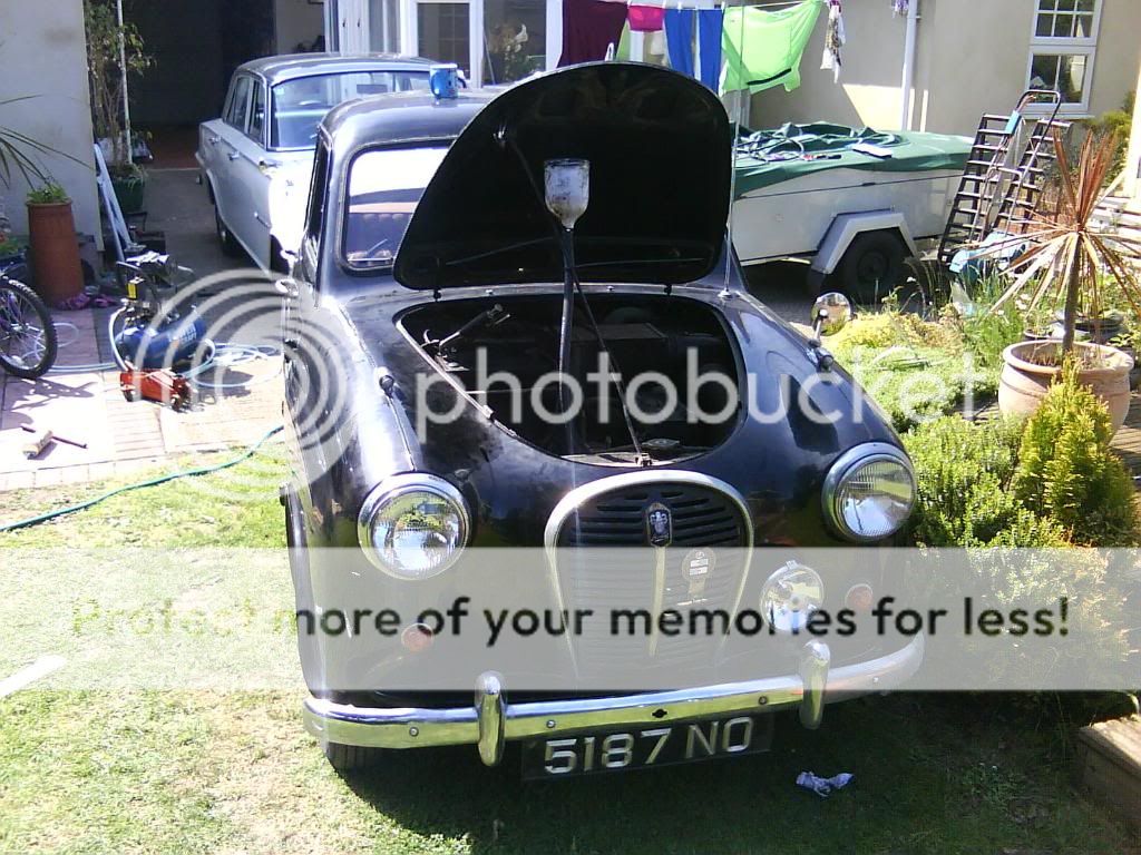

With the gravity feed attached:
Still plenty more to do, but it is just as good as I had hoped. The pictures don't really do it justice  _________________ Richard Hughes |

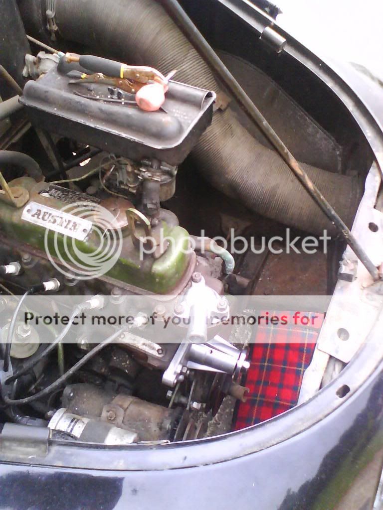

We also attempted to get the thermostat housing off but it was welded to the studs so took a lot of chiselling! Eventually we got it off to find a rusty old OE thermostat buried in rusty muck. There would have been virtually no water flow. It was the bypass hose that had blown out, and a new one has been ordered, along with a waterpump, top and bottom hoses, thermostat, and a few other bits and pieces.

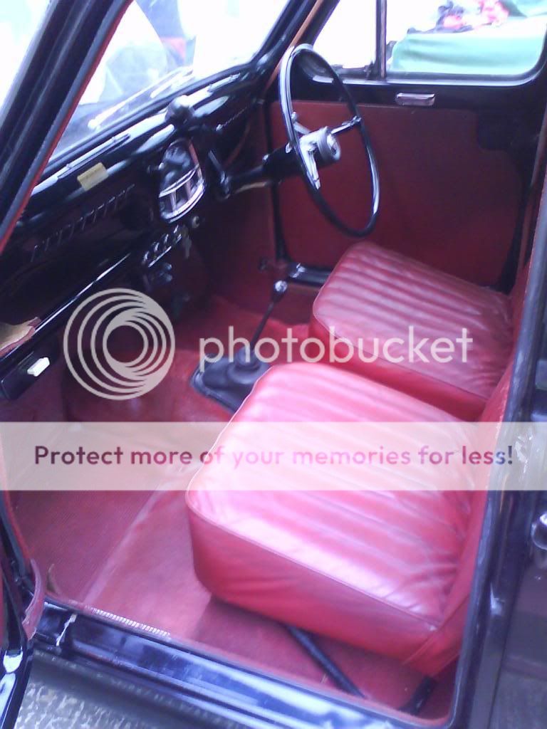

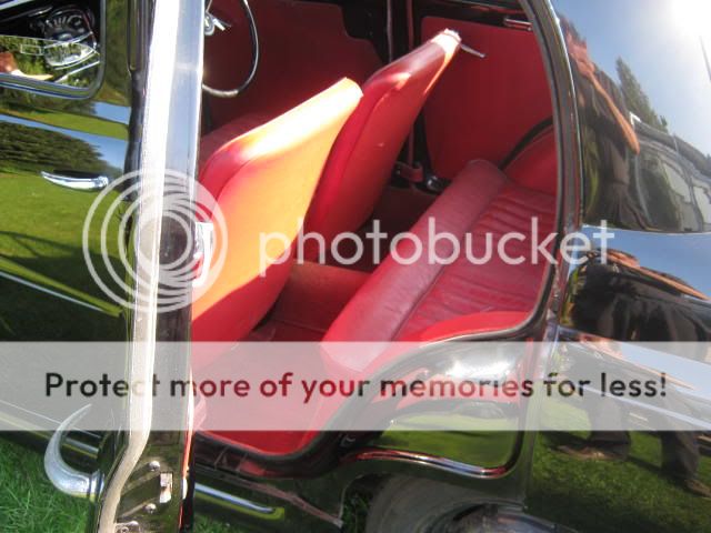

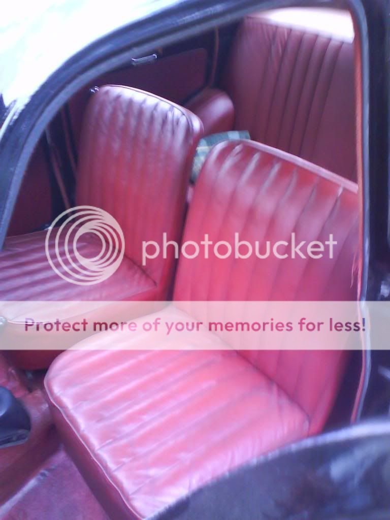

We also had a go at cleaning up the interior, we managed to successfully rescue about 95% of the original rubber mats, re-strapped the front seats and cleaned the interior, which has come up like new
Here is a taster shot of the driver's seat.

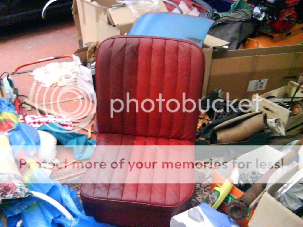

Posted: Tue Jun 15, 2010 10:15 pm Post subject: |

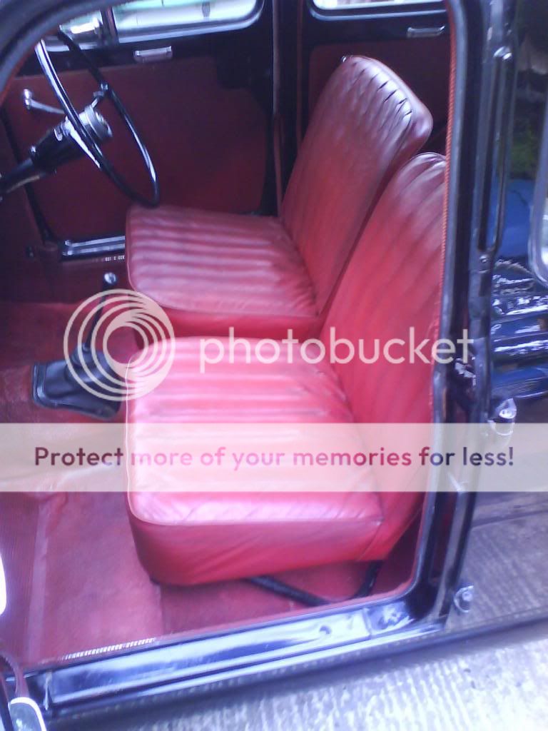

More work has been carried out. First we removed the seats and cleaned up the seats, carpets and the original rubber mats. New rubber seat straps have now been fitted.
And the finished result

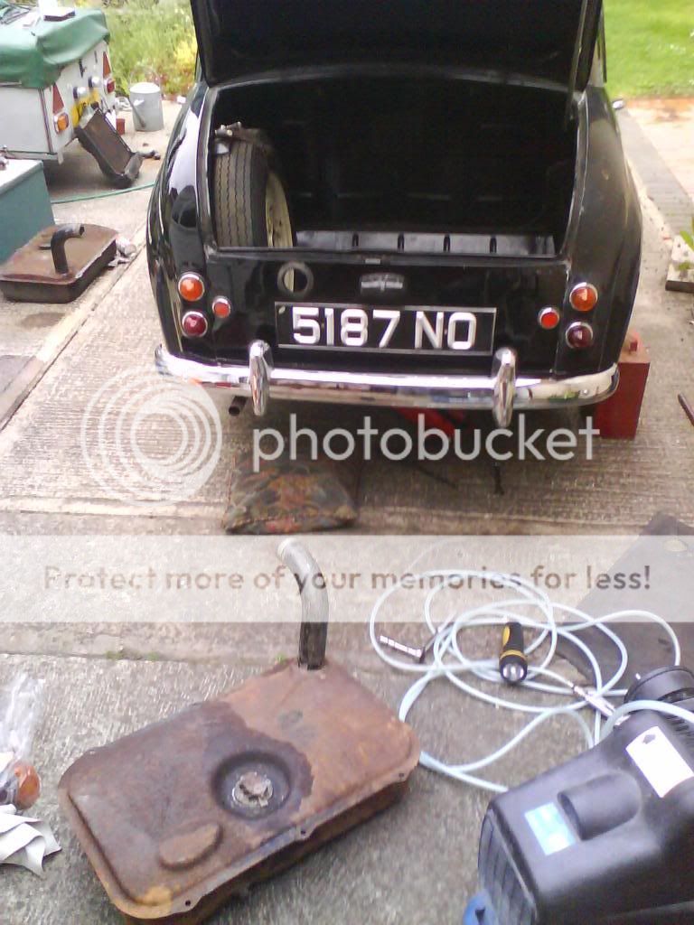

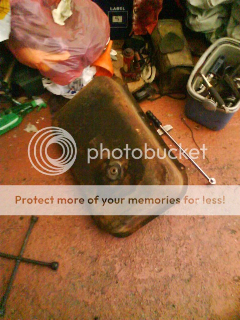

Right, so with the interior out of the way, we now made a start on getting the car running under its own steam. The problem was no petrol was getting through from the tank. First of all we tested the fuel pump, that was fine, then blasted the fuel line with an airline, again no problems, so we tried to syringe some petrol out of the tank. Nothing. I can only assume the pick up pipe must be blocked, and it is inaccessible
Luckily, we managed to pick up this secondhand tank at the National Rally for £20, it was an unknown quantity, but tests proved fuel was getting through it and after cleaning it out with old petrol, we took the plunge and changed it.
The original paint was like new under the tank.
Also we fitted a new bypass hose, top and bottom hoses, waterpump, thermostat and housing, and flushed through the radiator.

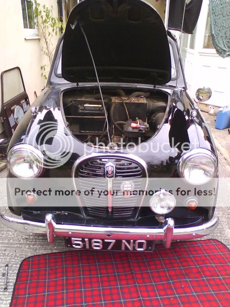

Result: Well, after a while we were able to get fresh petrol through, and it burst into life! Running under its own steam for the first time since 1987. Even the clutch that we thought was stuck proved to be free, and we have had it driving round the garden. It is incredibly smooth and quiet, with none of the usual timing chain, bearing or tappet noise.

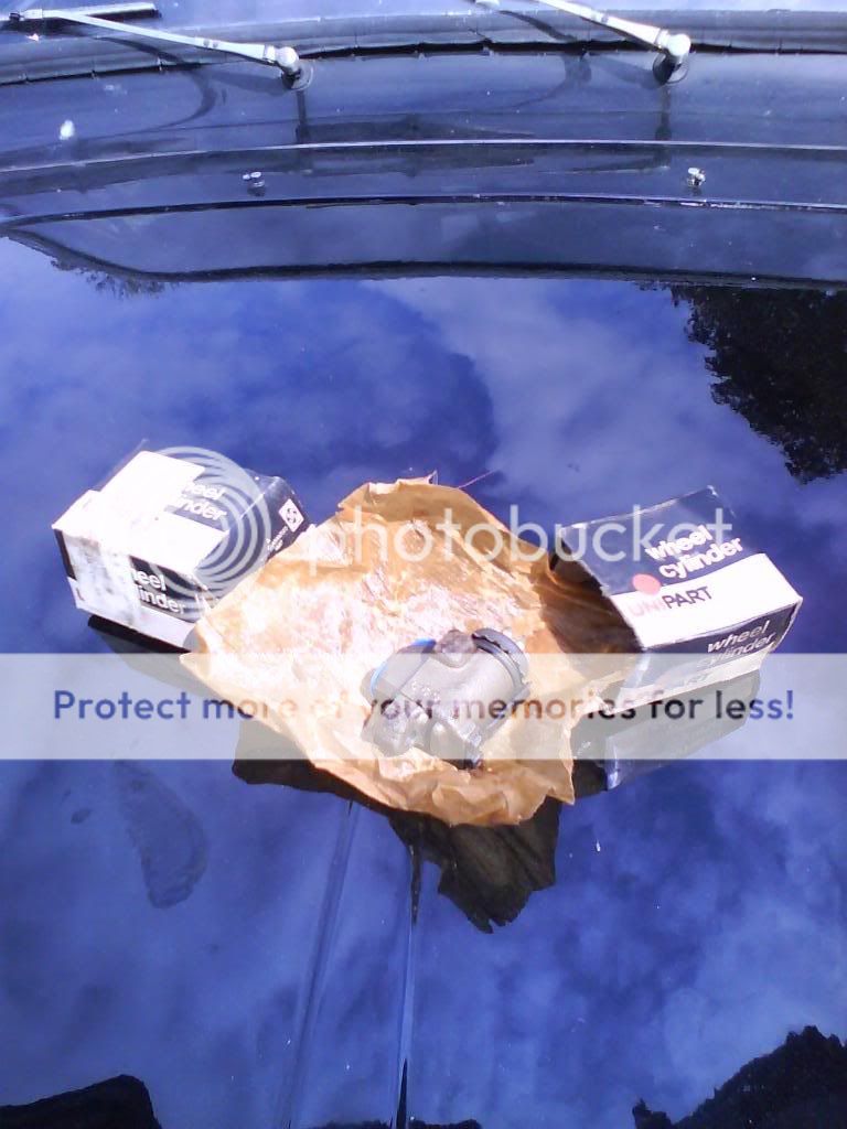

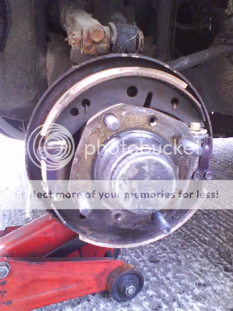

But there were no hydraulic brakes. We took the drums off and there appeared to be new wheel cylinders on the drivers side, but old ones on the passenger side. Anyway three out of four appeared to be stuck, so we decided to put some fluid in the master cylinder and see if we could get any pedal and free the cylinders. There was no fluid in the system when we first got it.
Anyway the other (obviously new and shiny) wheel cylinder on the drivers side freed off with little effort so we decided to fit the two original BL wheel cylinders that came with the car in the boot to the passenger side.
New brake shoes were already fitted at the front. I can only assume the previous owner bought four new cylinders, but only fitted two. Anyone who is into A30/35's will know these are like gold dust.
The master cylinder wasn't leaking or seized and is ok for the time being, but if it springs a leak we have a new one ready to go on. However the rear frame cylinder did blow out under pressure so we have ordered a new one.

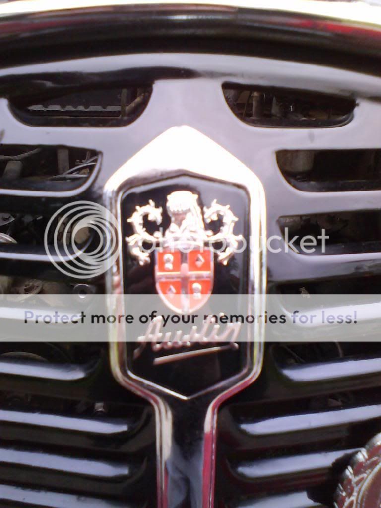

We also got a new grille centre strip to replace the rusty one, and a brand new grille badge from the Rally, the original one wasn't too bad but it was a bit faded and this one just sets it off so well
