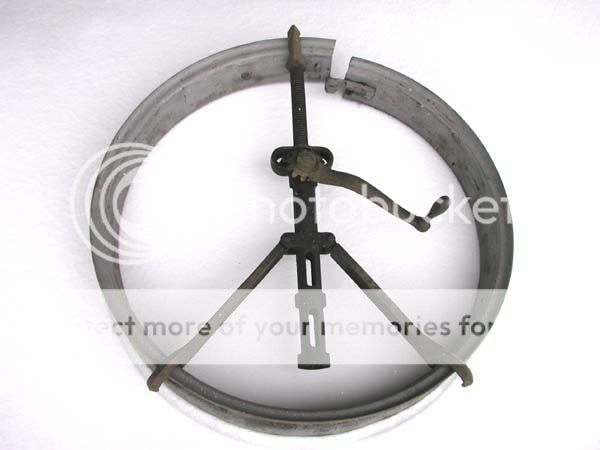

The base of the rim was completely flat, therefore it was difficult to change the tyre, but if the rim was 'split' i.e. in effect had a saw-cut across it in one place only, it could then be pulled away from the tyre, so releasing it, or when replacing the tyre, it would be placed over the contracted rim and the rim allowed to then return to its normal state before sliding the whole back onto the wheel. The tool that you describe would probably have three 'legs' to grip in the rim in three places, and when the winding mechanism actuated, the rim would be contracted, and slightly distorted, but with the result that it was smaller and would allow the tyre to slip either on or off as needed.

Here is the tool on the empty rim.
