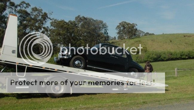

So Polly was duly loaded, and home we went, with my wife and myself feeling not to happy about the car's behavior for the morning.

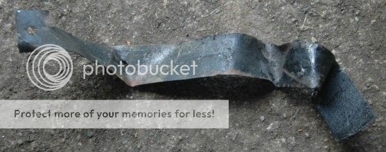

Once unloaded, and driven carefully to the house, I set off in another car to buy a new fan belt. Returned home, and started the fitting thereof. For those not familiar with the Rover P4, this is not an easy task. First one has to remove the oil-bath air cleaner, and then work in a very confined space to release the generator bracket. It was then that I discovered the cause of Polly's malaise.
That piece of strapping steel was caught in there, and must have been flicked up by the passing truck. It had come up under the car, and sliced through the belt. Imagine what other damage that it might have inflicted! So the breakdown was not really Polly's fault, she had been attacked by an unseen assassin.
Strangely enough, I found that the generator was set as close to the motor as possible- i.e., at minimum 'stretch' of the belt. The replacement 36' belt had to go over the fan- no problem, then over the harmonic balancer, and here I struck major problems. There was no way I could manage that. Off into town again, and bought a 37" belt. After some struggling, I managed to get it over all three pulleys. It was then that I discovered that the thread on the bolt that provides tension was stripped- this mind you after much fiddling and trying to tighten it, all by feel as the bolt is under the generator.
At this point we were beginning to think that we would have to abandon the trip, but there is always a way out of a problem if one thinks it through. A short piece of 2" x 1" wood, carefully positioned and jammed between the generator and engine block gave the belt the desired tension. A quick cleaning of greasy hands and arms, change back into travelling clothes, a very quick lunch, and we set off again at about 12.30- just five hours later than planned.
