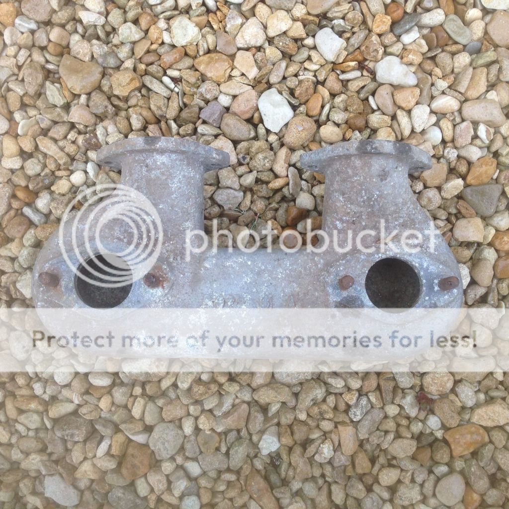

Hi all,
I am listing a twin carb ally intake manifold on ebay that came in a bunch of old spares but I have no idea what it is. Does anyone out there know so that I could target my listing slightly better please? Many thanks.

This looks like the air cleaner manifold for a 2½ litre Jaguar 1938 to 1948.
See: http://www.nostalgiatech.co.uk/New%20page%2018.htm
There is a similar manifold used on the 3½ litre Jaguar but the distance between the carbs is different. The pitch is 7.5" in the 2½ litre. (your second photo.)

That's great thank you very much
