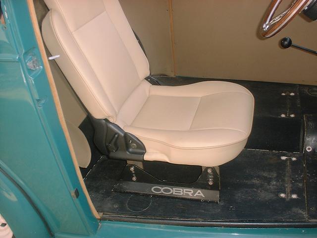

bought some landrover discovery alpaca leather 3rd row seat's to replace the std pop one's, which were terrible, like an old castiron bed spread, these are 100% better, took all the LR bit's off the bottom of the seat's, just have to make some mounting frame's now,
i hope you are keeping the original seats as that looks a very nice car and will be worth more as original. I am making changes to mine but all will be reversible and I'm keeping all the original parts, i.e. the 6v Dynamo has been replaced with an alternator in a Dynamo case but I'm keeping the old Dynamo in case someone wants to put it back as standard in the future.
