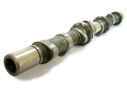

When installing the new camshaft I encountered a small problem.
It wasn't until the bearings were fitted and the camshaft installed that I realised there must be a part missing. Looking at an exploded diagram of the engine I realised that there needs to be a cir-clip by the rear bearing to stop the shaft from moving about. There is no mention of this cir-clip in three workshop manuals that I have and the new camshaft came without one fitted and no instructions to advise me that one must be fitted before installation. There is also no mention of it anywhere on Internet forums etc....although this little part is available for sale through the Octagon Club or Moss.
The most annoying thing is that I didn't notice my mistake until after I had plastered the shaft with 'Graphine' lube so it was a filthy task to take it out.
It was a fairly simple case of removing the cir-clip from my old camshaft and fitting it to the new one...then reassemble. Embarassed
Notice the groove for cir-clip.
