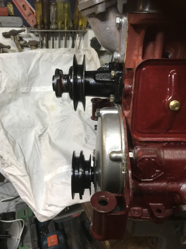

Having fitted the sump and timing cover I moved onto fitting the water pump and the elbow and thermostat assembly.
To my annoyance the water pump and crankshaft pulleys won't align. They are not even close!
The water pump is new and it's taper shaft is about 1/4" longer than the original. The body obviously can't go back any further.
The crank pulley is a new double one designed to operate both the dynamo and the supercharger. It pushes onto the end of the crankshaft up to the sprocket and has a woodruff key. The front oil seal runs on it's outside surface.
I am obviously restricted in getting the pulley much further forward by the key way. I cannot remember seeing any distance piece behind it.
Posts: 1295
PostPosted: Sun Mar 08, 2020 7:52 pm    Post subject: Reply with quote
Is there a watter pump pulley with a deeper inset?
Posts: 3294
PostPosted: Sun Mar 08, 2020 8:18 pm    Post subject: Reply with quote
I don't know. I shall have to speak to the supplier tomorrow. He says this pump is an improvement (upgrade) as it has 6 vanes instead of the original 4. The overall shaft is about the same length as the original but the taper part protrudes a bit further out from the body. The pump is sold by a reputable MG supplier and engine builder (who rebuilt my engine) so I assumed it would be a straight bolt on part.
None of the exploded diagrams of the engine show a distance piece behind the crankshaft pulley but I can't see any other way of making the pulleys line up.
I suppose there is always the possibility of machining the pump pulley (the pulley is original and would normally have the fan blades attached) so it can go further on the shaft. There may be a new pulley that goes better with this pump.
