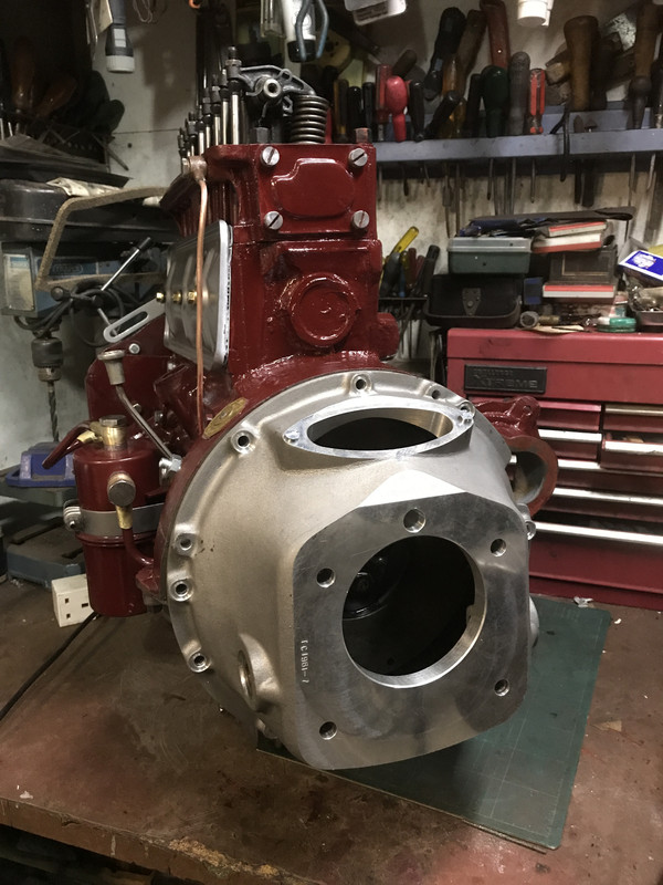

I struggled to remove a couple of taper pins from the clutch shaft in the old (broken) bell housing and ended up drilling them out. I had hoped to re use the shaft but it is too badly worn so I have ordered a new one.
New clutch forks are not currently available so I shall re use the original but I have ordered a new clutch release bearing. The clutch cover has been balanced and a new clutch plate came with the 5 speed gearbox conversion.
Another job was to remove the pilot bush from the end of the crankshaft. I followed a long established method of firstly making a cut in the brass bush with a hack saw blade then filling the hole with engine oil and whacking a close fitting length of bar into the hole. The hydraulic effect easily removed the bush.
I then turned up a brass drift to be a close fit in the new bush and gently tapped it into place.
I also took the opportunity of offering up the new bell housing to the engine. Just as well I did because it wouldn't fit on the dowels and I had to carefully relieve the holes with a round file. Eventually, after several attempts, the new bell housing went on and (in my opinion) looks good.!
