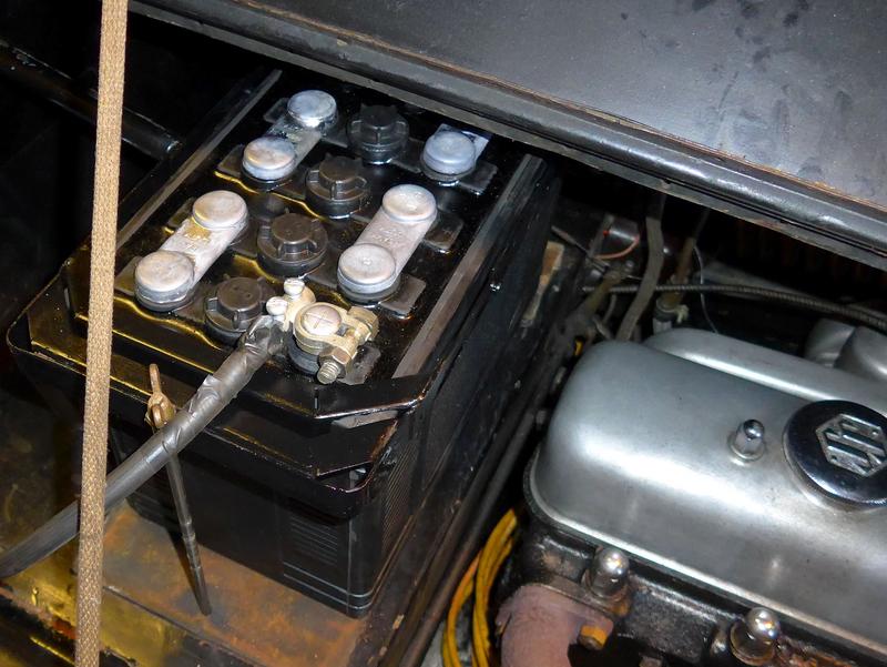

Not as good as a proper battery with ears but here's the new earless battery held in place with my modified clamp.

PostPosted: Sun May 05, 2019 5:40 pm    Post subject: old style battery Reply with quote
a possible marketing gap here for a new sealed typo silver whatever battery with a clip on cover that looks exactly like old style lead bars across cells. no need even be lead . plastic that looks like lead or a cheap alloy will suffice. imagine all those car clubs..old batteries that owners would like to see looking old but in fact brand new! Shocked

Posts: 6184
PostPosted: Mon May 06, 2019 8:09 pm    Post subject: Reply with quote
They seem to have forgotten about the lead cell connectors. Not an innocuous detail.
