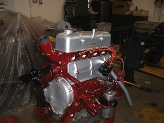

I sometimes glance at this photo of a newly restored XPAG ready for installation. It has been painted in the same combination of dark red and silver grey that I am having my engine.
This is not my engine but how I want mine to look. |
