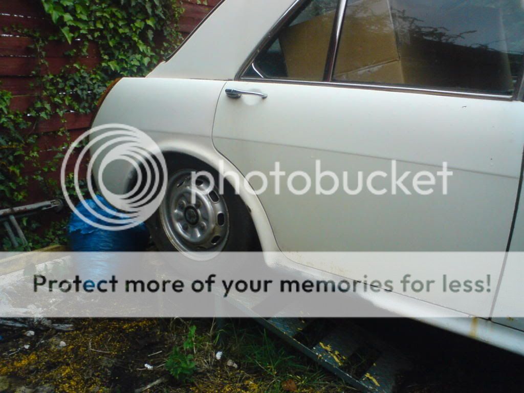

Just a few pics of my 1969 Austin 1100 - some of which I'm sure she really doesn't want you to see. These pics were taken with a very basic camera on a phone so I apogise for the quality of some.
Bought this car in August 2006 then left it untill I started work on rear subframe June 2007. Started hacking away at the cills (what a horror story) last autumn then the weather put me off till spring. Just finished welding the cills and floor last week.
now I need to bleed brakes and take it to the garage for suspension pump up. Had to replace o/s suspension pipe so I hope it holds when they pump it Embarassed
In an ideal world this car will be on the road SOMETIME in the summer as it is 40 this year.
I am not a perfectionist i just want a workaday 1100 to knock about in so don't expect lots of shiney polished bits....it's just not me. Wink

Got the car turned round this afternoon - no thanks to the petrol pump Evil or Very Mad
Fun and games lowering the rear end but rear wheels sat on bump stops without making an unwanted entrance through the boot floor.
More fun reversing on to ramps with no ground clearance - I put my foot down and hoped for the best.
