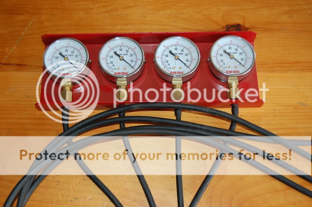

Another use for vacuum gauges is to balance multiple carbs.
I have 4, so who is the daddy! Laughing
