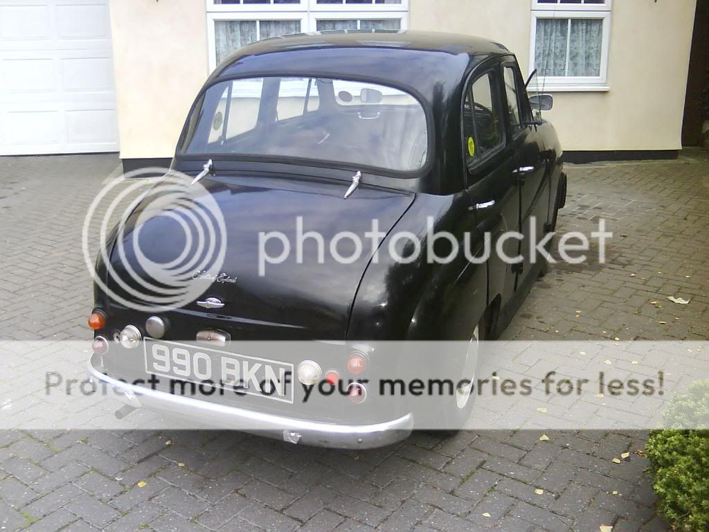

Bought this on ebay on Thursday, drove back from Tring on the Herts/Bucks borders on Saturday, and I've done about 300 miles in it so far!
The car was laid up in a barn in 1985 and was Mot'd in May this year for the first time in over 20 years. The car had only done 60 miles in the last 24 years, so it was a pretty nervewracking drive home! I stopped for a rest (the car was running fine) when I noticed steam pouring out of the grill. A leaky heater hose had caused it to overheat (since replaced). As soon as we got home we filled the steering box, which was empty, greased the suspension and steering which hadn't been greased for years, and adjusted the clutch. Unfortunately there is quite a lot of blue smoke on acceleration, so next week we're taking the cylinder head off and giving it a decoke, with new valve stem oil seals. The gearbox is really crunchy on third and fourth gears, indicating synchromesh wear, but it just adds to the character! (and is avoidable if you are careful enough).
Interestingly the car has only had 4 previous owners. The last owner only bought it in May. The previous owners were a husband and wife, she bought it in 1982, and transferred it to her husband's name 6 months later. Which means the first owner had it from 1957 - 1982. The car seems to have spent most of its life in the Welling, Kent area.
Slight problem on the way home...
