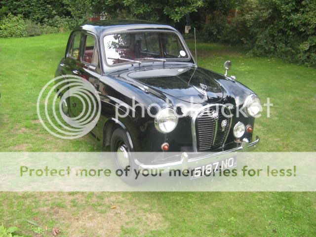

Took these yesterday.
I saw the Essex badge in an antiques shop and had to buy it - I think it looks great on a car that has spent it's whole life in Essex.
This one was taken at the Chelmer Valley Car Meet last night. It was pouring with rain and we weren't sure if we should take it out...but the good news is it doesn't leak and was dried off carefully before being put back in its dry garage.
It ran well all the way there, but has now developed a slight misfire. Considering it's still running on the old plugs, points, condenser and rotor arm from 1979 it's hardly surprising really! (my excuse is if it ain't broke don't fix it). We've done about 65 miles in it now and it is very nice to drive - smooth, quiet and as close to driving a new A35 as is possible really. We also changed the gearbox oil yesterday, which is a bit of a job without disturbing the original rubber mats!

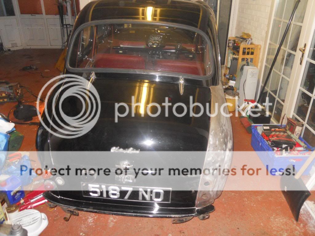

Time to drag this thread up from the depths, basically the last time I worked on the Austin was about October/November time when I stripped all the paint off the rear wing ready to respray it. Unfortunately it got too cold for spraying, so since then it's been sitting in the conservatory gathering dust.
Well I've got a couple of days off work, so decided to spend them getting 'Nobby' sorted out with the intention of getting it to the Austin/Morris Day at Brooklands Musuem on 6th March. Hmm.
The first job was to get some filler into the damage left when the wing was panel beaten back into shape after an accident. I have been told that the second owner was well into his eighties when he gave up driving, so I think most of the damage dates back to him. I spent ages rubbing down the filler with a little sander, 600 grade W&D then 1200 grade. It's looking pretty good now, one possibly two small low spots but we're hoping to get some paint on it tomorrow. The main thing - no rust!
I then fired her up (started on the 2nd attempt), moved her outside and ran the engine up to temperature.
I then cleaned all the dust off before moving it back inside and starting work on the n/s sill, which was very badly scratched.
So off came the paint, using the sander, 600 grade then 1200 grade W&D.
And that's now ready for paint.
The only bit of rot on this car is the N/S wing bottom, which has always been bugging me, so I investigated further. There are at least two more dents in the lower half of the wing, so the plan is to respray just the bottom half as the top half isn't too bad. It's original and I'm not going for concours.
