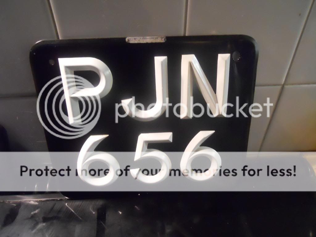

A quick update on said numberplates. I decided a while ago it would be nice to make up some original-style Bluemels plates with the original registration for shows and possibly to go back on the car at some point!
Unfortunately Bluemels plates are quite rare, but luckily after posting my wanted ad on a few forums I found someone who had a good supply of secondhand plates + digits. I sent some money, and a few days later a parcel arrived Smile
Here's the plates after I offered the digits up to see which ones fitted the original holes, filled the redundant holes with body filler (I think there were about 10) and drilling a few new ones!
The original registrations on these plates were SLL 544 and RAB 620, both long gone I'd imagine.
Mocked up:
Primed:
And that's where I got to today, I will try and paint them tomorrow and get the digits permanently fixed on.

PostPosted: Tue Jan 25, 2011 6:48 pm    Post subject: Show plates Reply with quote
Nearly there
A couple more coats...
Finished!

I'm going to try and track down the owner of the original registration number, to see if I can buy it back, although I'm not holding out much hope really as I reckon they'll either ignore me or give it the old "I had it valued at two grand three years ago so it's probably worth more now". I really hate this cherished plate business. Evil or Very Mad

PostPosted: Tue Jan 25, 2011 8:48 pm    Post subject: Reply with quote
i checked,and that reg.is not on the DVLA database Richard,PJN 565 is though.
Posts: 2138
Location: Suffolk
PostPosted: Tue Jan 25, 2011 9:05 pm    Post subject: Reply with quote
Yeah it's on retention according to the DVLA. I don't think it's a mistake as I have a 1984 tax disc application from the DVLC with 656 on it.
565 is on a Mercedes SLK Rolling Eyes
