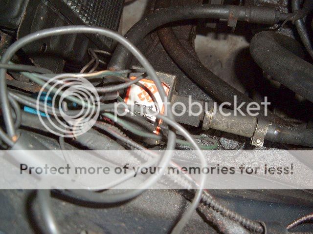

On my Rover P5B I have it mounted low at the front - its been here for over 13 years and works very well apart from its noisy and is louder than the engine at idle outside but you cannot hear inside with the windows closed.
This is not the recommended position which would be at the rear as a pusher rather than a puller but this would be far noisier and would not allow the reserve petrol supply
