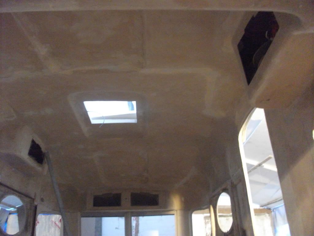

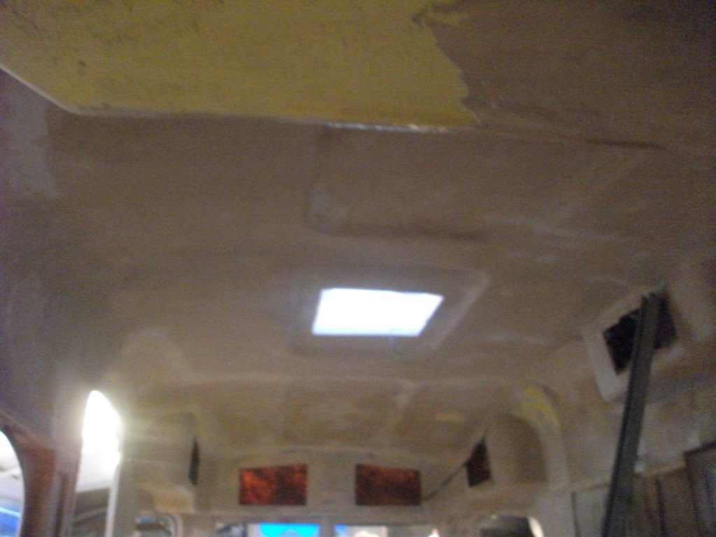

these are the latest pictures of the willerby vogue and the ceiling is back in and the rear panels have been taken out as we needed to take them out as behind them was just full of rat nests and junk and foam and all the wood on the backs of the panels was all rotten and were in a bad need of being replaced
