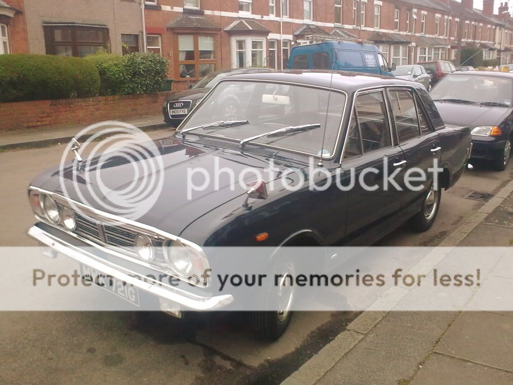

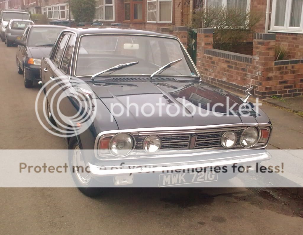

A Ford Cortina 1600 GT....
Completely unmolested and virtually original.. Very Happy
A lovely beast indeed! It`s been off the road for 3 years due to one thing or another, and failed its MoT on tyres,clogged washers and brakes binding. No real surprise I guess, three stationery years will allow many things to seize up..so, to business!

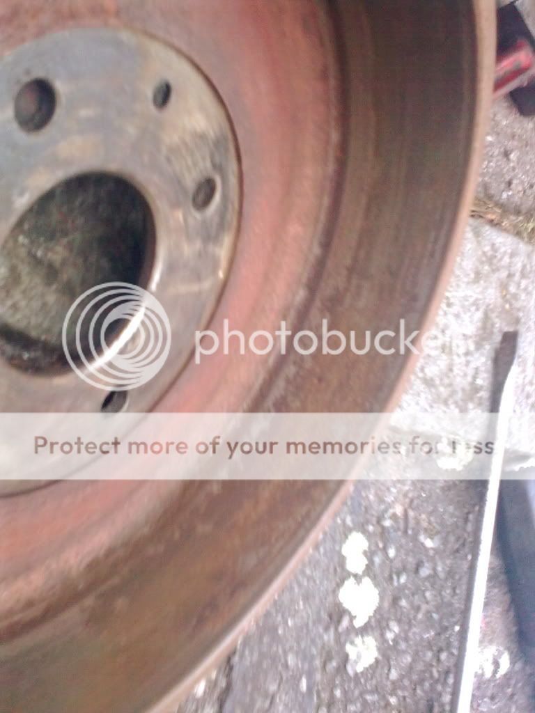

The drum, not surprisingly, was pretty rusty and dirty Sad ..
Better! Coarse sandpaper followed by wet and dry works wonders! A tickle up of the adjuster, wheel back on, exactly the same on the other side too..

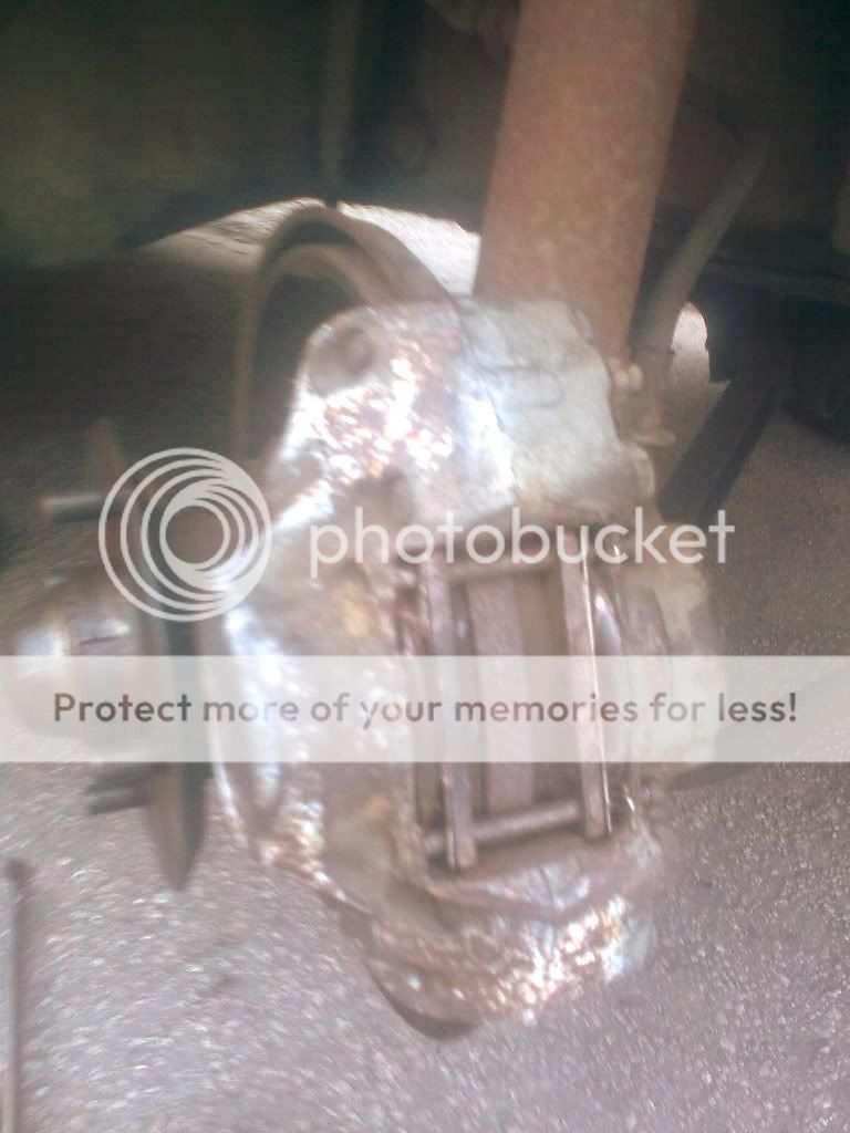

A similar story on the front disc brakes too ( yes, discs..GT!..). The discs and pads were in pretty good shape, but the pistons were all but seized in the callipers, as were the pads. Patience Rolling Eyes , clean brake fluid application to the pistons under the rubber gaitors and a fair amount of easing them back, brake pedalling them out, easing back etc soon had all working smoothly once more. Copper grease on the pad backing, top and bottom too and all back together..
Dropping the jack, I had this lovely sight Razz , and had a further look round the the old beast

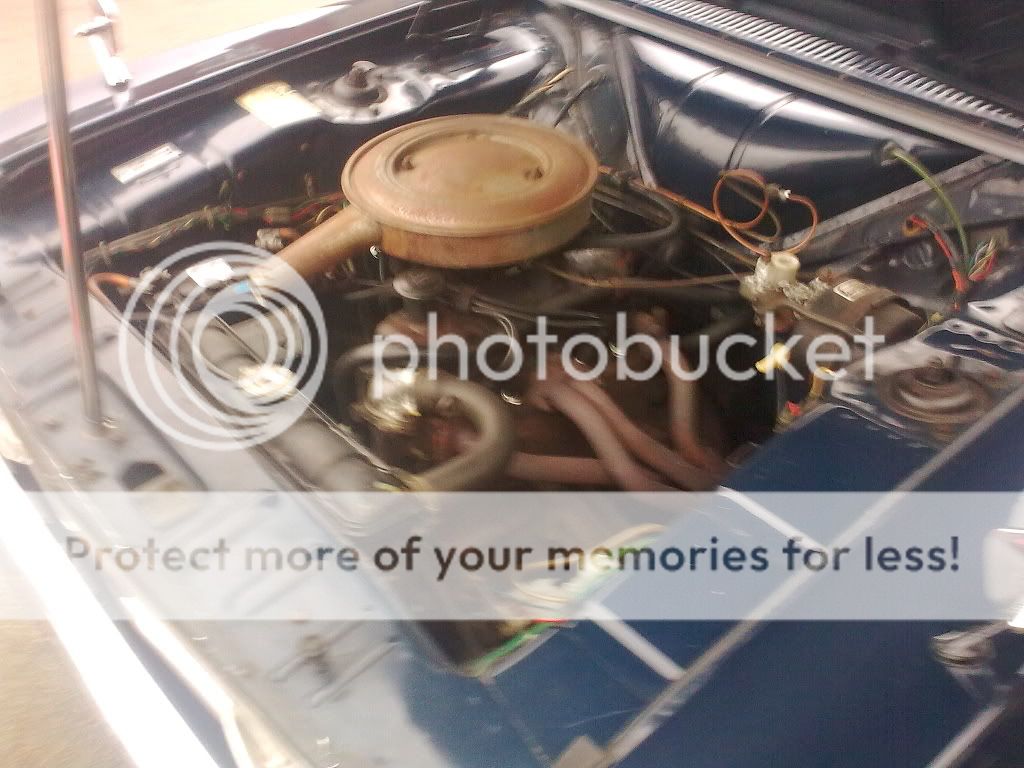

Hiding! The original glass bowled fuel pump, remove the bowl, clean the mesh filter and refit....those were the days Laughing !

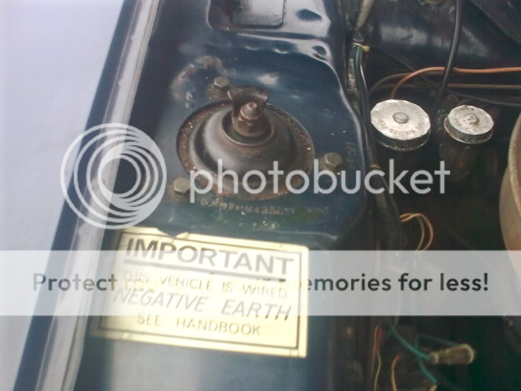

The strut tops were in very good condition Shocked and certainly wont need welding anytime soon. Well, job done, so....time for a test drive! DEFINITELY needed...who wouldnt want to have this view, sitting behind that wheel Cool ?
I turned the key and she started instantly, off we went, gingerly avoiding potholes, getting the feel of her...and she went beautifully. I didnt push the old lady but even light pressure on the accelerator gave instant response, and it wouldnt surprise me if even now, 43 years after it was built, it would give many laptops a run for their money! Thanks for reading this indulgent rambling effort, next time it`ll probably be Bertie`s MoT, but a 25 mile run may be happening at the end of the month c/o the local sidevalve club...and he`s invited Smile ! Catch you all soon.... Laughing
