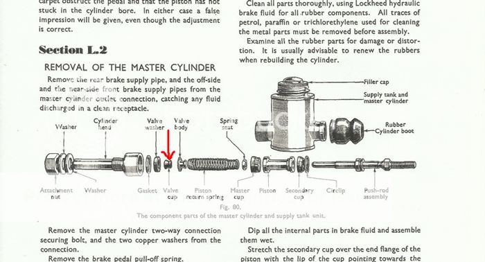

Ok to add further to this. Ive taken the MC off and found it was quite seized. Ive got a couple of inquiries in about repair kits, but have one question.
As I was carefully (and I mean I was conscious of what might happen) undoing the cylinder head off the back of the MC, what might happen did. Just as I took off the cylinder head I was just about to cover the end just incase it all when springing off into the wild blue yonder, and of course it did. DOH! Mad I retrieved everything except the "valve cup". As pictured below.
Can anyone tell me if the kit will come with one of these or am I to be looking to source this part. And if the answer is "No your up the creek without a paddle) then anyone got one lying around from an old MC. Once again happy to pay any postage.

Hi Craig
The valve cup is normally part of the kit, its also a very common part fitted to many other vehicles, my MGA has the same one. If its not fitted it wont actually stop the brakes from working, (its possible your cylinder had its valve cup omitted?) its function is to maintain a slight pressure in the system even after the pedal is released, there have been problems with some of these valve cups in recent times; they have held too much pressure causing the brakes to bind, folk have got round this by putting a small hole in the valve cup.
A bit more info can be found here; http://mgaguru.com/mgtech/brakes/bt101a.htm

PostPosted: Sat Nov 23, 2013 8:53 am    Post subject: Reply with quote
Thanks Dave. Ive just 5 mins ago purchased a full brake rubbers kit from the UK. Master cylinder and wheel cylinder rubbers. And yes the valve cup was in the kit.
Interesting reading about the method of releasing pressure. Not quite sure if my gorrilla hands want to go poking holes in tiny rubber bits, but if I have problems with binding brakes after I know where to start looking.
