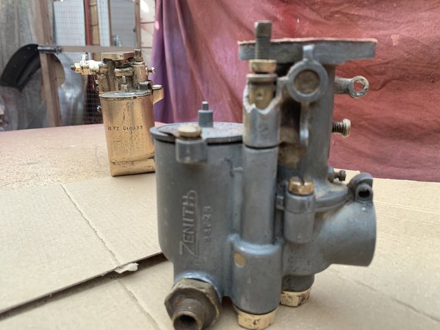

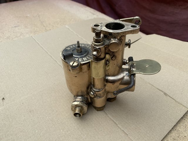

This is a problem familiar to many Austin Seven owners. These Zenith up draught carbs are made of muck metal - otherwise known as Mazak - and they all go at the same place. What happens is that the screw holding the slow running device is over tightened and the collar breaks off. Mine has been like it for as long as I can remember and I have patched it up several times.
When an old repair failed again I decided to take the easy way out and swap the carb for a bronze one that I have had knocking about for years.
Apart from cleaning it up, I swapped over the good bits from the damaged carb. These included the needle valve, the seat of which I ensured would be a good seal by mounting it - and the needle - in my lathe. I used some metal polish to get a good seat.
The choke flap and lever on the bronze carb was a home made affair and pretty crude, so I changed it and the lever. I replaced the split pins with new but the flap return spring from the Mazak carb was usable. Getting the spring set to return the flap to it's open position was more fiddly than difficult.
I swapped the spring steel clip that holds the float chamber lid; the bob weights in the lid were good so they stayed.
I also swapped over the slow running device because it had been over lightened at some time and split at the end...a common finding.
The main and compensating jets were different so I have swapped them over too. I have 0.70mm for the main and 0.75 for the compensating which seems to be the normal combination.
The correct round head brass screw for locating the slow running jet and the brass adjuster lock nut were also both transferred.
A good clean up and the replacement carb is ready to go.
Whether or not the engine will perform as it should is yet to be established.

At the time of writing I have to report one or two niggles with fitting the carb.
After ensuring the surfaces were perfectly flat, I made a gasket using the correct paper. I used hole punches for accuracy then cut it to shape. I de greased all the surfaces and applied a little Wellseal before fitting to the manifold.
Unfortunately, There is insufficient room under the top flange (on one side) for a nut AND a spring washer. I am not happy with just a couple of brass nuts to hold the carb to the manifold; I suppose I could use a dab of thread lock?
Another difference is that the bronze flange is thicker than the Mazak one which might mean finding some slightly longer BSF bolts.
Also, the slight difference in carb body length means the existing rod for operating the choke is slightly too short so I will have to make a new one.

The "new" carb is now fitted to Trundles and I must say it looks nice. I have managed to get it set up in the garage...but what will it will be like on the road ? I know it prefers to be run on E5 petrol.
These old Zenith carbs were originally tuned by switching to different size jets...but of course today's user has to make do and mend. As this carb is using the jets from my old carb I am hopeful that the performance should be similar.
One potential improvement should come from the butterfly spindle which compared with the Mazak has very little wear; no more disguising the potential cause of a lean mixture with blobs of grease! Razz
