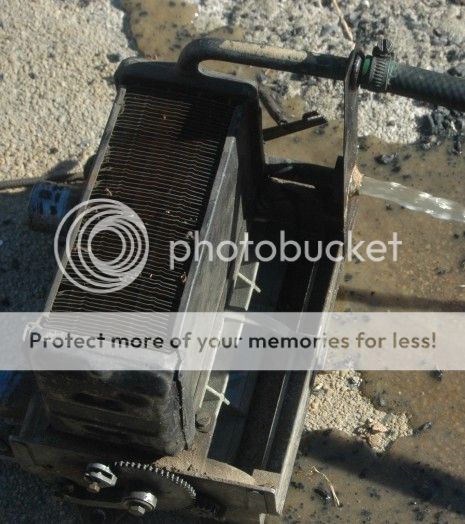

Both tap and heater matrix were blocked. I managed to loosed the gunge that was in the matrix tube, so then coupled it, via a hose, to the garden tap and flush the whole matrix through. I was pleased that there were no leak to be seen.

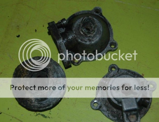

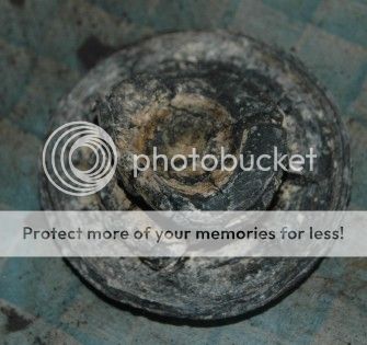

Now to tackle the tap proper. It is held together with four set screws with nuts, and after undoing those, I was able to prise the two halves apart. Apart from all of the gunge, there was a strangely distorted piece of rubber inside.
The question now arose, what did that rubber look like originally and where can I find another one?
After cleaning the cavities inside the tap it became apparent that the screw and nut on the outside was an adjustment for the rubber diaphragm, and that a washer on the inside end of the screw should be embedded into that diaphragm. Now things started to become clear. The tap operates on a simple cam principle. As the outside lever moves the cam causes the diaphragm to be pressed over the tap inlet to stop the flow, or alternatively to be withdrawn from it to allow the flow.
Perhaps that distorted old diaphragm was originally quite a simple shape. Now I needed some sheet rubber and suitable punches.

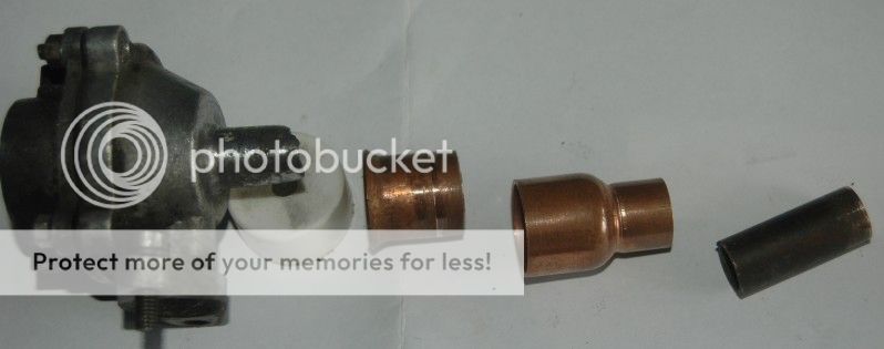

Now to make a suitable connection for the hose to tap joint. Much wire brushing and scraping ensued to get rid of the corrosion on the tap's snout. Next I took a very short piece of 3/4" ordinary household copper pipe, and belled the end to give more surface area for the eventual joint. Next came a 3/4 to 1/2 inch reducer, and finally a short length of 1/2" copper pipe.
After cleaning the copper inside and out, I sweated them together with ordinary solder.

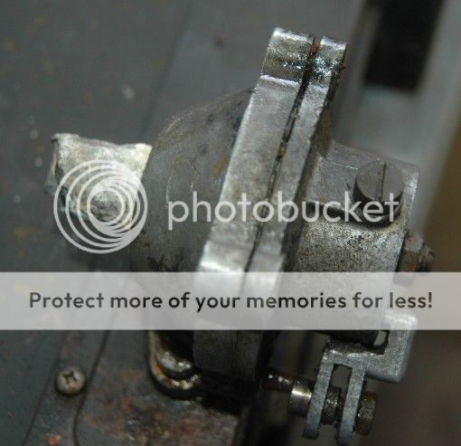

Next I used an American product that restorers there swear by. It is called J.B. weld and is an extremely strong, epoxy type material. This I used to coat the 'snout' and interior of the 3/4 end of the pip[e assembly. J.B. Weld is a slow-curing formula so it was left for 24 hours.

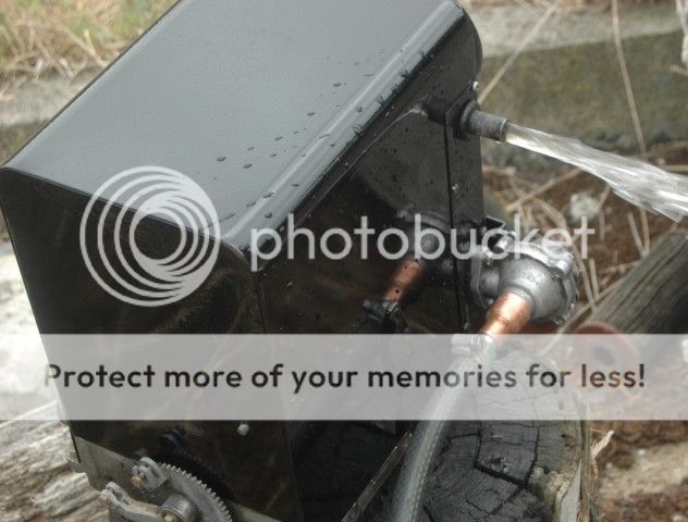

In the mean time, I worked on the main matrix assembly, cleaning the gears and freeing all moving parts. Now was the time to put the outer box case into place and test the whole thing for leaks and water flow.
