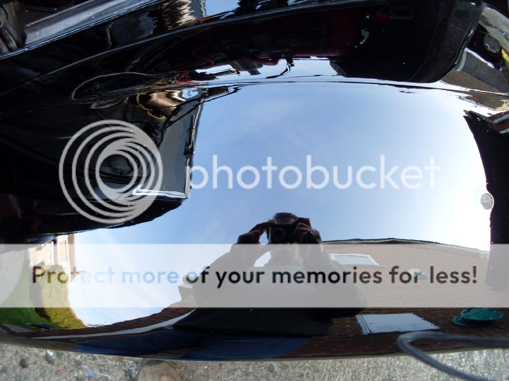

PostPosted: Sun Mar 14, 2010 3:13 pm    Post subject: Reply with quote
I concur = paintmaster enamel and Purdey brushes, did my wolseley by hand last year with no experience at all and below is the finish you can get ! This is straight off the brush - no finishing at all.
