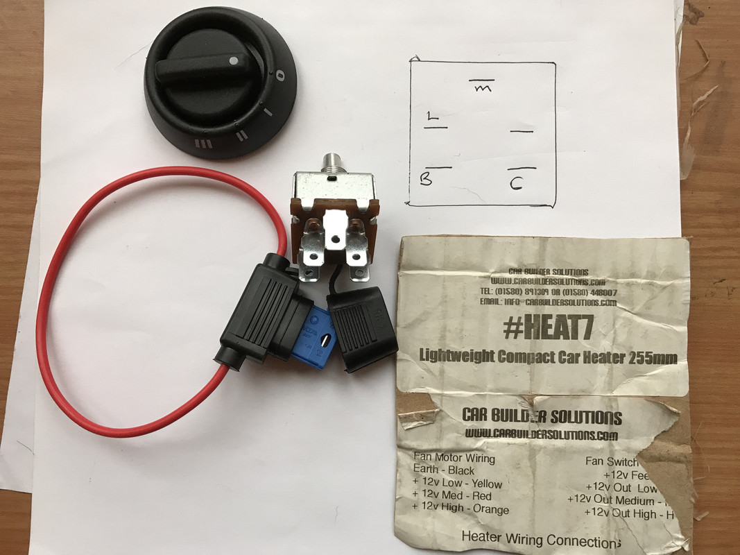

I am getting confused with this. The fitting instructions state that 'B' is the live feed to the switch. However, the fuse comes attached to a red wire which according to the instructions is for speed 2. terminal M.
Low speed is the yellow and high is orange.
C is live out to a warning light.
No colour is suggested for the live wire but I assume the fuse will be let into it somewhere.
It seems wrong to have a red fused wire in the middle of a different colour live wire.
Totally confused. Sorry.

I don't think that is what it means - that's just a generic fuse holder that comes with red wires already crimped to it, I bought a couple from the NEC show a few years ago.
I would imagine the fuse should go between the 12v supply and the input line / 12v feed into the switch, so that all heater speeds are fused.

Thanks Mike. I get easily confused with electrics. It's the same with the "B" terminal which initially I thought was B for black; then I saw it was for the live feed.
