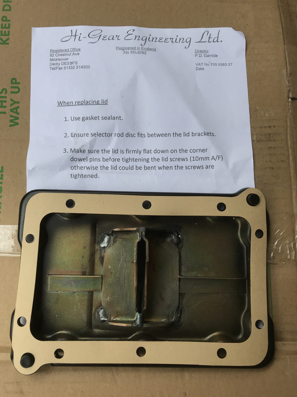

In a somewhat unwelcome development I heard from Hi Gear Engineering this morning to say that there could be a problem with the 5 speed gearbox they supplied.
Apparently there are issues with the spot welds to the brackets on the underside of the cover which in a worse case scenario could result in a gearbox failure. The fault is not of their making so in that respect I am most grateful that the engineer took the trouble to contact me. A replacement part is available f.o.c.
Here is the gearbox cover. As it happens there seems to be no imminent problem but It's better to be safe now than sorry later.

Collected the 'new' gearbox cover today. The brackets are much more secure with decent welds.
