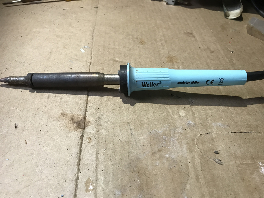

My TC rewire soldering has been stopped in it's tracks with the failure of my soldering iron.
The Weller 100 watt was supposed to be "the best". At £100 I would have expected better in terms of reliability. Admittedly, the iron is long out of warranty but I am still feeling gutted. I might just as well have bought a super cheapo for all the good this is.
Is there anyone here who might be able to help me repair it? I have bought a cheapo replacement which should be here by the end of the week.
(Oh, and yes the fuse and plug is O.K.!)

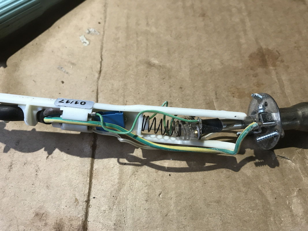

Trouble is I don't know what all the various parts/wires etc. are supposed to do... or how to test them. Confused

Clearly you need to establish what still works, so check whether power is coming from the transformer. Check whether there is continuity through the element. check whether the thermostat has continuity when cold. Having done that I think you will have established what is faulty. The thermostat works from the magnetic properties of the tip. They can stick an giving them a thump can persuade them to work. Just whack the tip holder/element onto your bench top.
Sorry, I can't remember whether the element and thermostat can easily be dismantled.

Is the transformer the white thing that the green wire and white wires are connected to?
...and what does the blue bit do.?
There is a clear plastic bit that the spring fits on to?
The spring is about the only component I recognise but I don't know why it is there.

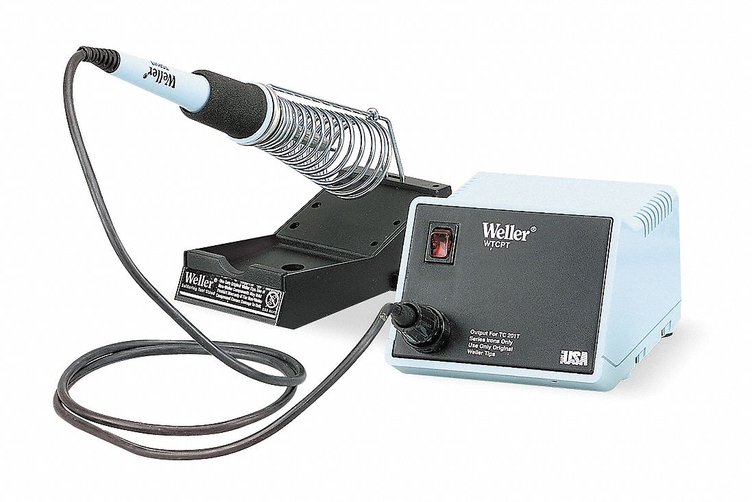

Sorry, I assumed you had a temperature controlled Weller like this:
https://static.grainger.com/rp/s/is/image/Grainger/4Z762_AS01
Please ignore my post. I think you have mains voltage iron. I don't know if it has the magnetic thermostat but you could try hitting it on the bench.
