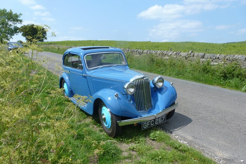

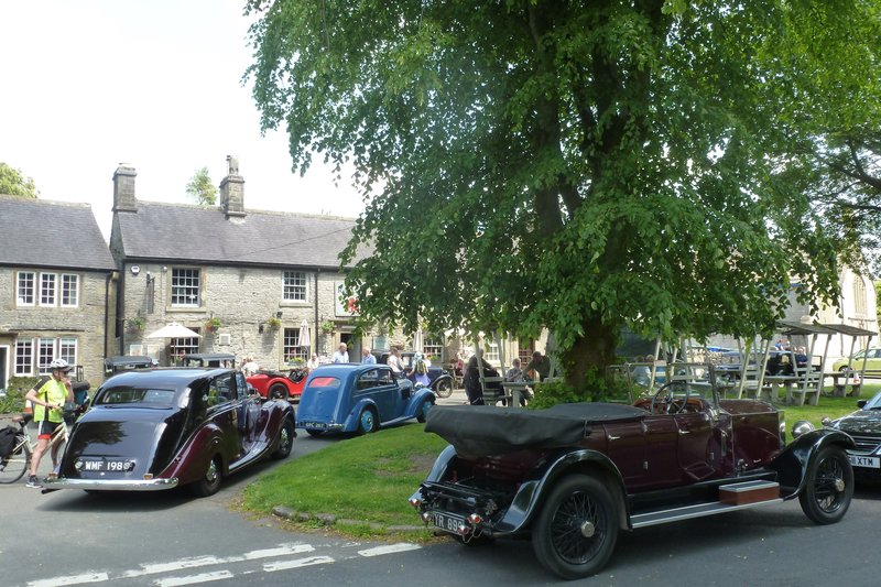

Well, eventually we are back on the road! It took four oil pumps, all supposedly correct for the car, but all different in detail, to make up one good pump. The idler gear had seized on the original, and one of the other pumps was missing that gear, which suggests there may be a fundamental problem there. A friend who specialises in racing Formula Vee cars confirmed that it is a known problem with air-cooled VWs, so he has engineered a similar mod for my pump - a machined groove in the spindle and cross-drilling of the gear itself.
We now have 50psi hot compared with around 20-25psi before, and hopefully no more problems with the pump! After nearly a year off the road, a 70-mile round trip sees it back in action.

Excellent news Mike. I goes to show it's not just what you know but who you know that counts.
Posts: 4174
PostPosted: Fri Jun 13, 2025 10:24 am    Post subject: Reply with quote
Yes, very good news and a great bit of advice.
Lovely to see her back on the road.
