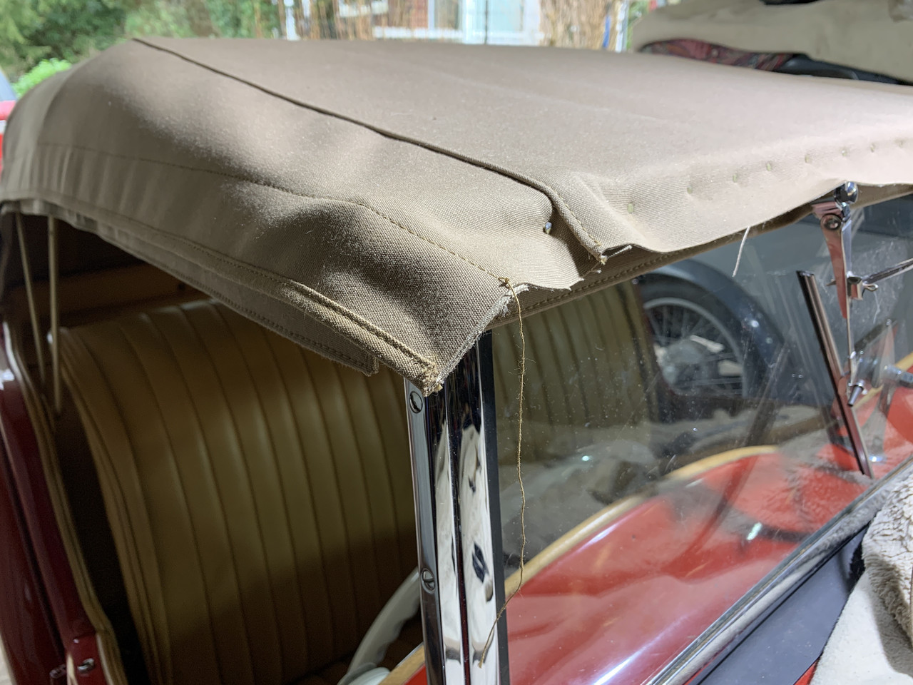

On another matter I am not entirely happy with the hood. I knew that the leading edge would need trimming before folding under and tacked to the front bow. However, I believe there should be a seam which has not been stitched.
This is not my forte ,,,to say the least!  |

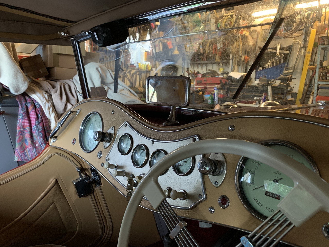

Before I can take the MG on the road I need to fit rear view mirrors. Some time ago I bought a new drivers side mirror which should be mounted on the windscreen stanchion. Two BSF drillings are provided.
I experienced some difficulty in assembling the head to the arm as the clamp was too tight...but eventually the two were persuaded to go together; but not before I had discarded the rubber cup washer as there was simply not enough thread available with it present.
Mounting the mirror was an easy enough job... although I did need to reduce the length of one of the BSF c/s machine screws.
A "demso" mirror came with the car and although not perfect I have decided to use it for the time being. This mirror has a single 'foot' and should be mounted in the middle of the double hump scuttle. Strangely, the hole in the scuttle is slightly too small and it will need to be opened out to 5/16". Also I have discovered that during construction of the new body tub, Andrew Denton had added some strengthening timber to the the scuttle frame. A 1" piece of Ash is now directly under the hole in the scuttle where the mounting bolt should go.!
I have sourced a 1.5" x 5/16" BSF bolt for the job and I shall need to drill a hole through the wood. Obviously I shall need to drill down from the top. Normally the windscreen would obstruct an electric drill but fortuitously the screen folds flat!
I thought it would be a good idea to fit a mirror to the near side ...but there are no drilling's in the windscreen stanchion on that side so I will need to think again about that. |

That is very good advice but I don't think my mirrors will be a problem. here they are on the car.

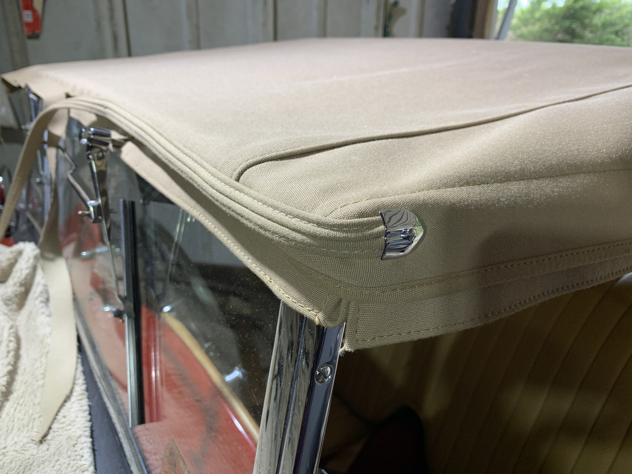

Getting back to the hood. If I have one criticism of the hood supplied, it seems to come up a bit short from front to back. With with the weather strip closing the gap at the windscreen, the rear corners are only just covered. It is understandable, I suppose, because the car has had a new body.
I have finished the n/s front corner
Just the o/s corner remains to be done...
