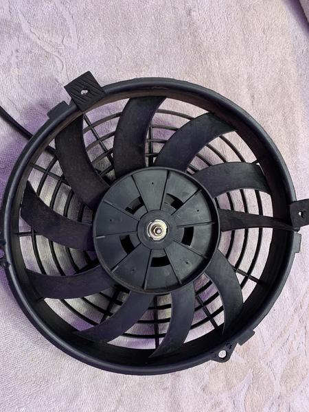

My helper didn't materialise... but I have started on the strip down just the same; trying to imagine it is just another customer's car and not my own!
I have had the pleasure (if you can call it that) of benefiting from the alterations I made to the wiring that would make removal of the lights easier; little realising that I would be making use of them so soon!!!

I managed to remove the fan without having to lift the bonnet. All I did was to unscrew the hinge clamp from the scuttle and with plenty of protection for the paint, lifted slightly and pulled it back enough to expose the rad shell.
The headlamps had to come off but thankfully the supports remained in place (which saved taking the side lights and wiring out) as I was able to free the brackets from behind the shell and wiggle them out.
With the 6 retaining bolts removed (and the filler cap off) the shell lifted up and away from the apron valance with no trouble.
With the fan off, the problem was immediately obvious. One of the blades had been fouling on the shroud and had been forced back. The plastic blade has broken so I have no option but to buy a new fan. As it happens the feed wire came off in my hand so that would have happened sooner or later.
The quality of all these cheap parts flooding Ebay etc. is as you would expect; rubbish.
I have found a Kenlowe fan (N.O.S.) being sold privately ...but the label says "blow only" which would rule it out.
SPAL seem to be better quality; if more expensive...but you only ever get what you pay for!
I should have one early next week.

My neighbour took one look at the way the electric fan was attached to the radiator core with thin plastic strips (like cable ties)
and opined that he didn't like it.
His argument is that vibration could eventually cause the ties to cause the rad to leak.
I don't know if this could happen or not... but it has got me thinking (a dangerous thing in itself!)
The new SPAL fan us basically the same design as the one it will be replacing, so I could mount it in the same way... or, if I am to avoid
dismantling so much of the car should I ever need to remove the fan again, then I need to find a different way of mounting it
in the engine compartment.
I am toying with the idea of mounting the fan on brackets attached at the shell mounting points. The main difficulty is ensuring that
the assembly is rigid, as I don't want the fan to vibrate against the core but on the other hand, not too heavy or intrusive.
All I can say is "watch this space".
