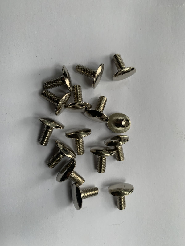

In total there are 62 x 3BA special oval head screws that are designed to slide and lock into the back of the chrome trim strips that finish the edges of the windows.
The screws then pass through the fabric and holes in the frame, where they are attached on the inside of the car.
However, before I can fit the trim, each piece (which is of a different length and with different angles) needs to be mitred. To do this the trim sections will need to be 'dry run' fitted to the frames. For this I will need sufficient 3 BA nuts.
I thought I had enough 3BA nuts for the job ...but then realised that those I have are 2 BA. This has meant ordering a supply. Unable to find 3BA nuts in stainless steel, I have chosen plated ones in an attempt to keep the rust at bay.

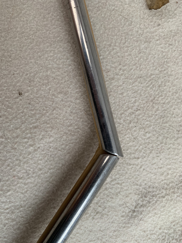

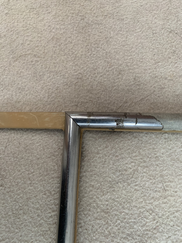

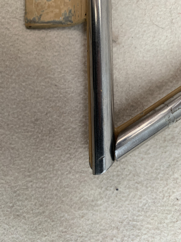

So...the original used TC side screen trims are something of a curate's egg; ie. good in parts.
Unfortunately, someone has mitred them incorrectly.
They should obviously look more like this:

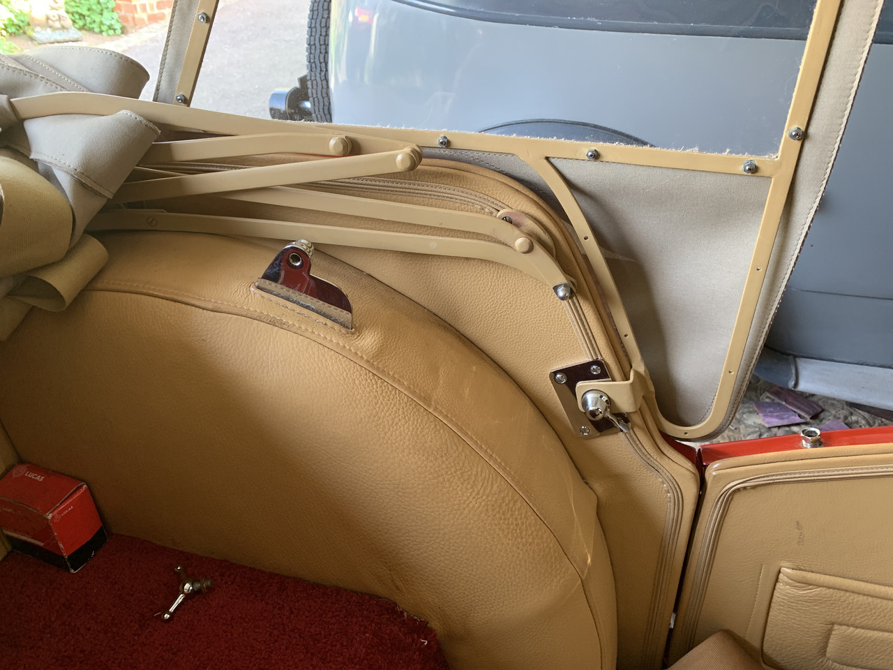

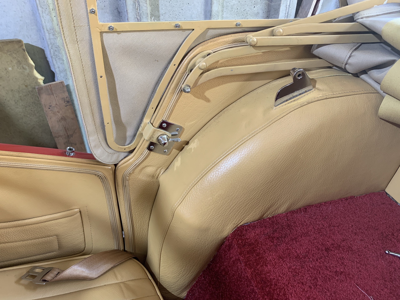

After what seems like an age, I have finished making up the side screens. The smaller, rear screens are seen here fitted to the body tub. Note the rectangular chrome plate attached by four raised c/s wood screws is let into the hidem banding. (I needed to cut out a small section of banding so that the plate would sit flat on the panel) The side screen front leg has a forked end that slots onto a stud protruding from the plate held firm by a wing nut.
Unfortunately, the legs of the front screens are not long enough to reach their securing plates. I had forgotten about this and it means they will need a 3cm piece welded in.

Thanks for following. The colour is called "Mountbatten Sand" and is a top of the range natural leather by UK Leather. It took four hides to complete the interior trim - which apart from the new seat, I did myself. Not blowing my own trumpet, but I think the results speak for themselves and are a big improvement on the original leather/vinyl mix.
I am glad you like the seat belts. Belts were, of course, not originally fitted... and are for many "purists" a step too far...but as they can be tucked away behind the seat I am happy that they do not detract from the aesthetic.
With regard to the front side screen frames; I was not happy that the "leg" was not long enough to properly locate onto the stud. Theoretically, they should fit... but like everything to do with this car they will need "tweaking". Even with the chrome plate mounted at the top of the door card, the hook would not fully reach. Therefore, I shall be adding a 3cm piece to each front side screen 'leg'. This should allow me to mount the plate flat on the panel below the hidem banding (save cutting it) and be secured fully with the wing nut.
