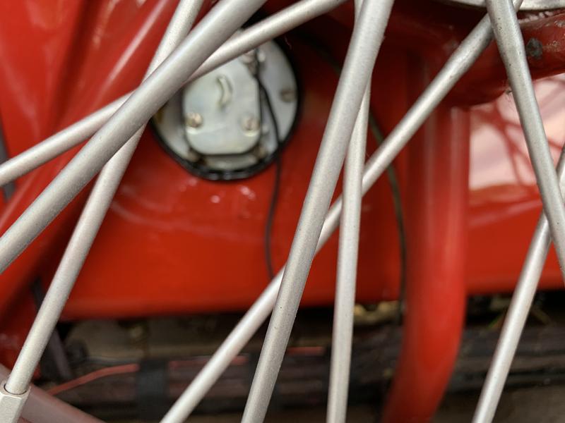

This morning I noticed a strong smell of petrol.
...No...surely not???
Well yes . The sender unit seal - a new rubber one - is leaking!
I could hardly believe that all my work has been in vain. The new paint is ruined. Again!
I could cry.
Crying or Very sad

I have started the draining down process. First the spare wheel has to come off. This is done by knocking the spinner anticlockwise, until the assembly can be withdrawn. This, is to my mind, is a wonderful piece of engineering; involving a spring loaded key that ensures the MG logo remains upright regardless of the position of the spinner once it is fully tightened,
Next the spare wheel carrier is removed. This is a heavy duty 3 piece tubular structure bolted to the chassis rails and the rear cross member. Again, a very nice, solid part of the car.
With the spare wheel and carrier out of the way there is better access to the drain tap.
(This is a lever arm ball valve; part of the new electronic hydrostatic petrol gauge system that I added to compliment the original low level warning light.)
Despite the limited ground clearance there is just sufficient space to allow an old washing up bowl to be slid under the drain tap without having to raise the car. While doing this work I have been wearing protective gloves and taking care not to spill petrol on the ground.

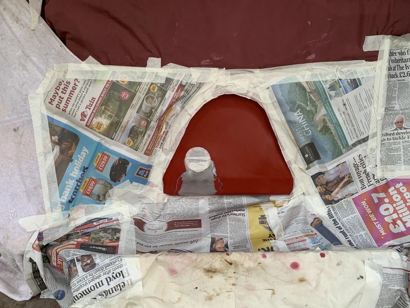

When enough of the petrol has been drained out, the supply and earth wires can be removed from the sender unit along with the six perimeter screws. With the sender unit out, I can check the area for flatness.
A new cork gasket is on order but while awaiting delivery, I can mask off the area and remove the petrol ruined paint and prepare for spraying.
...again! Rolling Eyes

The surface appears to be flat enough so I would think the fault lies with the rubber gasket.
Next time it will be good old cork!
Anyway, with the area rubbed down and masked off the next job is to apply a couple of primer coats. Being stainless steel, I am using a 'Jenolite' primer which is specifically designed for "difficult surfaces".
Here we go again!...
