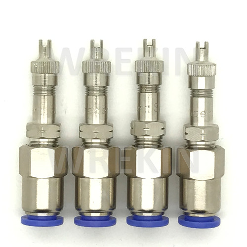

Famously, I have a habit of not being able to leave well alone. Before taking the car for its test, I thought I should perhaps put a bit more air in the suspension. The upshot of doing that was to become apparent when I arrived at the garage.
I drove into the testing station and got out. Shortly after the car had been logged on, there was a loud explosion from under the bonnet and the suspension collapsed.
The noise attracted the attention of a mechanic (who I also know) who came running to see if we were O.K. At first he thought an air bag had exploded. Then came two more explosions and he mused it could perhaps be a high pressure relief valve. I knew what the problem was but kept my council for the time being.
As the car had been logged on, it had to go through the test even though the outcome should have been a fail. However, as the tester knew I would correct the fault he passed the car.
The story might have ended there but as it happened the problem couldn't have happened at a better location. I parked the car up in a corner of the fore-court and lifted the bonnet. What had happened was the plastic tubing that I had used for the Shrader valves had failed. It was not strong enough to withstand the extra pressure that I had added.
I removed the T pieces that connected the air bags to the valve block and Shrader valves and connected the valves directly to the air bag lines directly. I then drove the car round to the garage and asked to use their air line. The mechanic was intrigued with what I had been up to and assisted with inflating the suspension.
With a reasonable ride height restored; I drove home...but not before getting the thumbs up from the M.O.T. tester.

Yesterday, when I had got back from the M.O.T. station, I set about adjusting the air suspension. With the Shrader valves now directly connected to the air bags it should have been a straightforward job ...but one of the valves decided to make a bid for freedom and shot off the end of the pipe and became lost.
I searched for two hours but in the end gave up and with the light fading decided to connect the two rear pipes together with a 6mm T piece fed by a single Shrader valve. I have no spares but have subsequently ordered some more.
Today I had to make a 20 mile round trip and the suspension seemed to be fine again.
