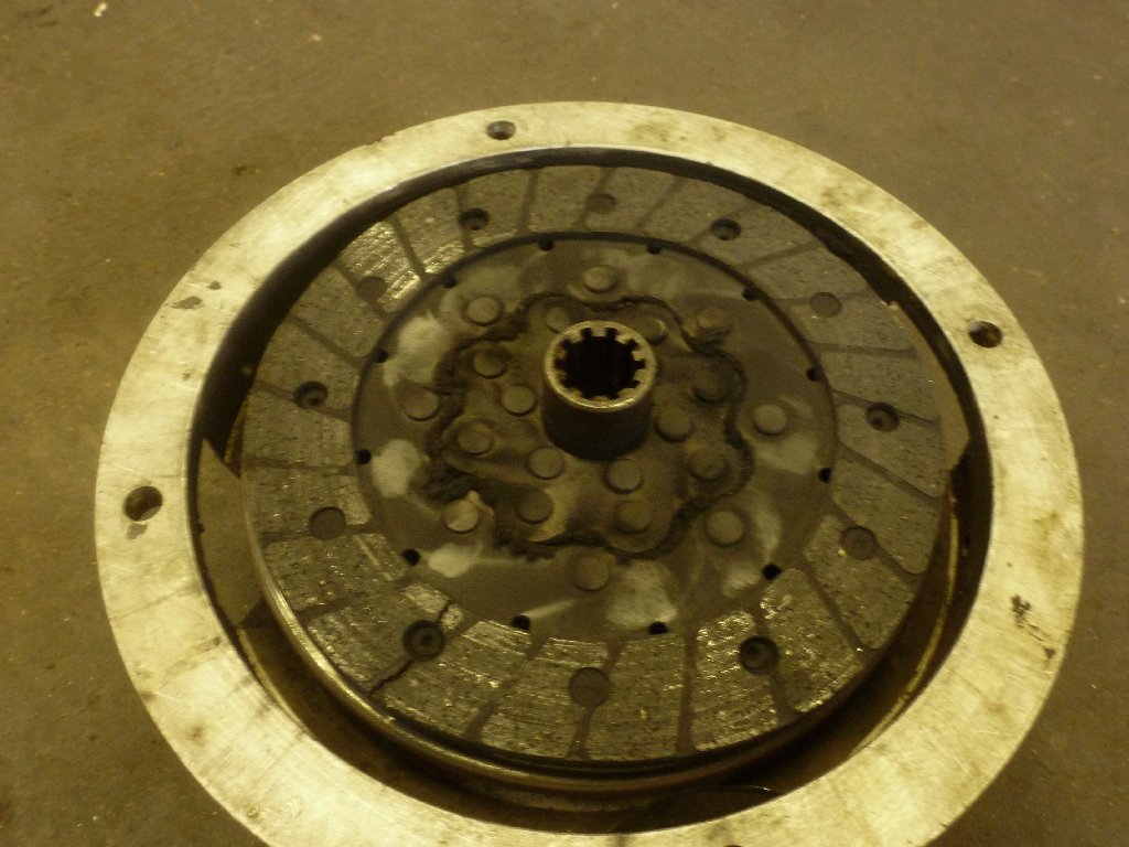

All back together, but the first test run resulted in loss of drive; out with the engine again to rebuild the clutch - new linings, pressure plate, springs, bearings ...!

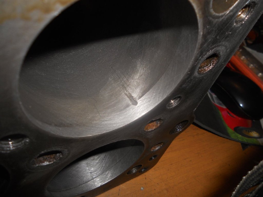

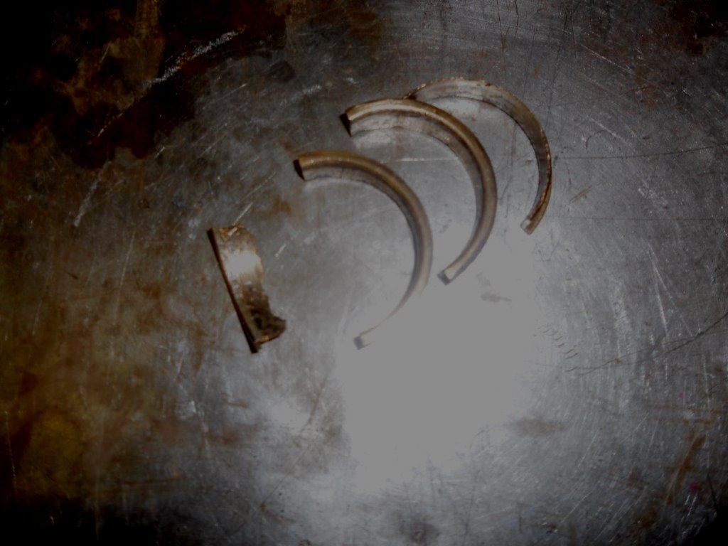

So it was engine out again, to reveal a very sorry state - it was the front main bearing that had seized, but the big ends were on the point of disintegration, the pistons were in a bad way and the bores badly scored ...
The bearings are white metal in bronze cases, and one of the big end cases had broken up:

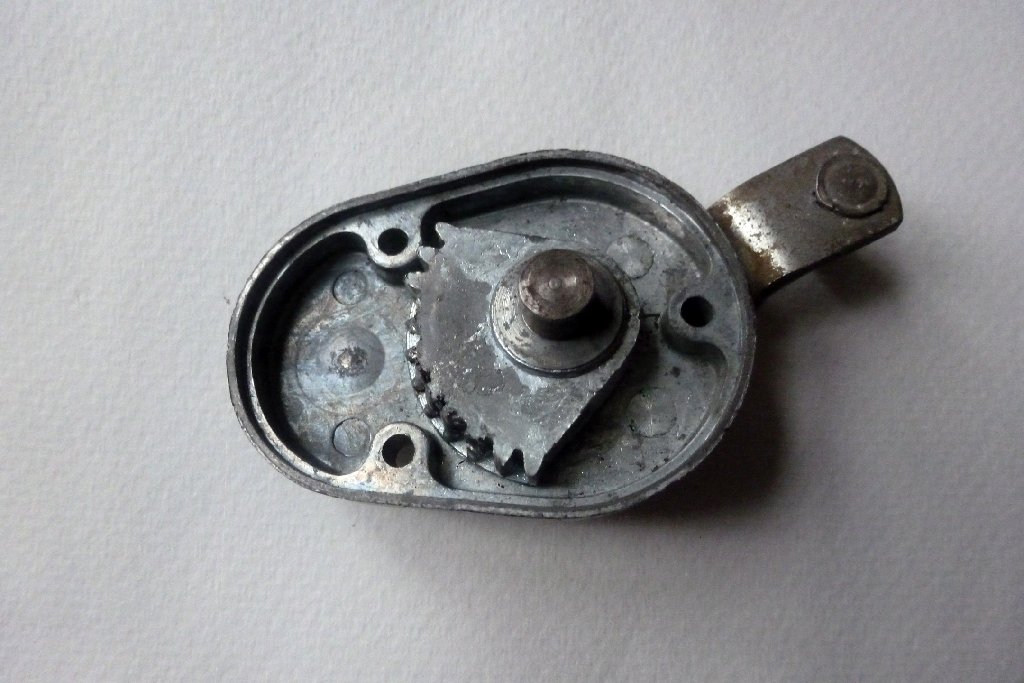

Needless to say, the suggestion that the car had only done 80,000kms turns out to be very far from reality; it's far more likely to have been round the clock four or five times! Just about everything I've touched has been worn out to the point of being unusable. Even the windscreen wiper wheel-boxes were beyond redemption:
