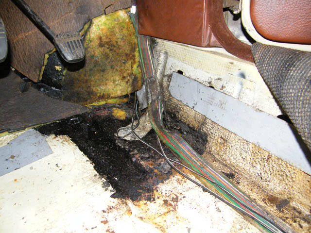

Then the carpets, so I could both clean them and inspect the state of the floor. There's only so much you can inspect on a driveway when you're buying a car so I couldn't very well go pulling carpets up and the like. I had looked and poked as much as I could and knew the carpets were wet in the front. I also knew the car had been used and it was winter, so the wetness could just have been from wet shoes. I'd later learn it wasn't entirely that at all, it was some historic repair work and a bad windscreen seal.
Most of the floor was actually not that bad, especially so for a Princess, so I mostly just covered everything back over when the carpet was cleaned and put any sort of remedial work here a good way down the list.

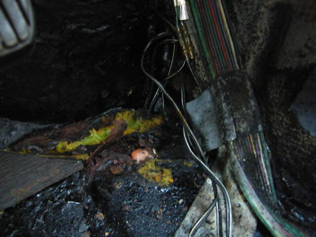

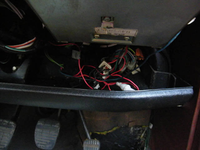

the initial inspection of the car did highlight a 'repair' that should have concerned me a lot more than it did at the time.

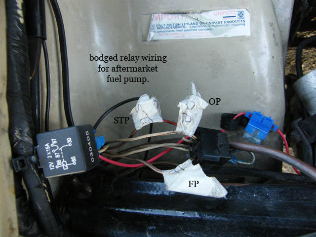

It certainly highlighted some questionable wiring. Fair standard stuff for an old cassette deck instalation, unfortunately.
This was also ignored in the short term. It wasn't affecting the functionality of the car so rather than pick at scabs, it was left alone. Instead, I turned my attention to such fripperies as rechroming the centre console trim, a job that turned out remarkably well. For my first attempt I was impressed and it's lasted almost unscathed for the last eight years, even after being removed and refitted several times.

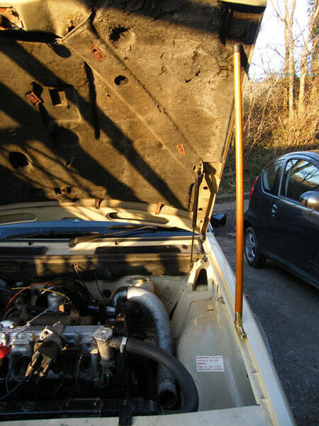

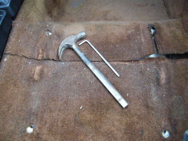

The bonnet rams didn't work at all, I carried a walking cane in the car for quite some time as an impromptu solution.

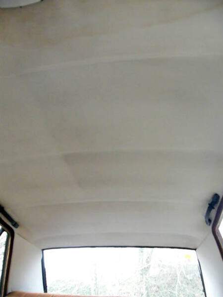

There was a lot of dirt all over the inside of the car too. Now, I had a tiny bit of history with the car that said it was restored and won shows in the 90s. The approach to keeping it show-worthy inside seemed to involve spraying an extra layer of silicone spray over the dirt every now and then. It was really quite disgusting inside.
As you can see here from the partially cleaned headlining, everything was just covered in greasy grime.

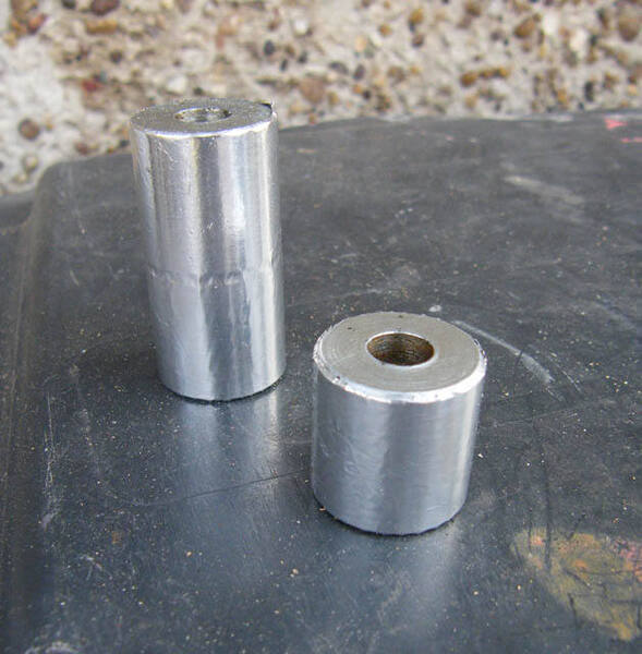

I focused on what jobs I could do with materials I had while I was saving for the more important things. This meant I was learning how to do things I hadn't done before too, for example since the rechroming of the centre console trim had gone so well, I tried the same method out on the once shiny spacers that go under the seat rails, thinking they'd look fantastic and make the interior just that little bit nicer.
This simple wrapping of the parts in aluminium tape worked remarkably well and they looked lovely, until I fitted them and then they were practically invisible. They still look lovely, eight years on, on those rare occasions you get a glimpse of them.
I'd finally got all of the encrusted filth out of the interior and while it was really very tired it smelled nice and it was a pleasant place to be, feeling more like a comfortable living room than a car.

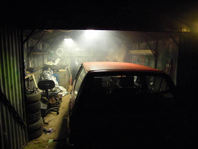

Where were we? Ah yes, the Princess stuck at the bottom of the drive, blocking the access road that ran down the back of the property. This was an issue, the drive was too steep to push the car up and the access road didn't have anywhere the car could be rolled to out of the way, so we managed to roll and push it up the access road and get my broken Polo out of the garage to miraculously tow the Princess onto the drive. The poor little Polo needed some help with this even so.
It created rather a lot of tyre smoke.

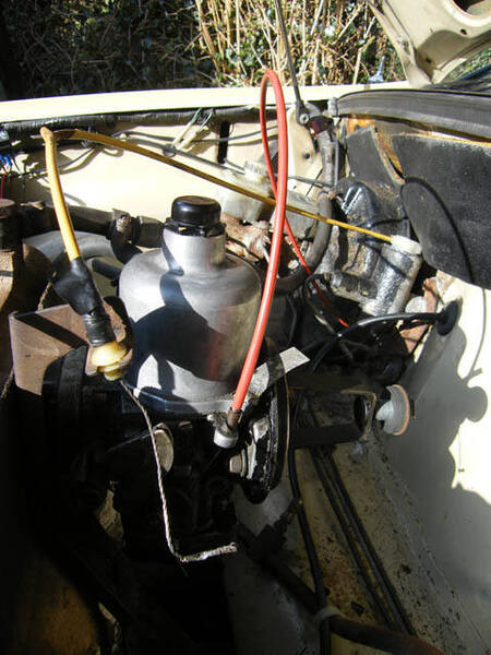

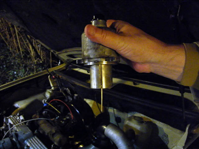

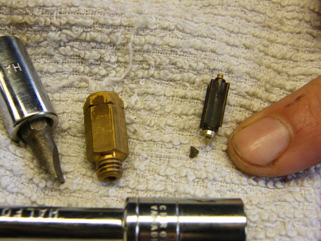

With the Princess safely on the driveway, we could see what had gone wrong. I was fortunate that the garage had power and that I had people who could help that had more knowledge of what might have gone wrong than I did, so we popped the top off the carburettor to find our first problem. That bit is not supposed to be bent. This was the first time we'd removed this too, so who knows how long it had been that way.
The oil in the dashpot was dirty and had sediment in it, and the dashpot itself had several layers of thickly applied silver paint, a common theme in the engine bay.
Unfortunately we didn't find the cause of the problem that evening and eventually had to call time on it and approach it again tomorrow. We did a more thorough strip down of the carburettor and that's when we found a big bit of grit in the float needle jet. There was also sign of wear on the float needle itself.
That done, on reassembly we found the throttle cable end was so badly frayed that it simply couldn't be reinstalled. Unfortunately, to remove the carburettor you had to disconnect that cable and we weren't sure it would go back on. I didn't have a spare either.
Improvisation was called upon and we acquired a Peugeot 107 throttle cable which was trimmed down to suit. The cable came with a little nubbin that screwed on the end to prevent it fraying and this worked very well until a proper cable was acquired.
The car still hadn't wanted to start so after going through the ignition components, finding the points and rotor arm, distributor cap and spark leads, and spark plugs themselves to all be fine, we purchased a condensor. We could have just fitted electronic ignition, but that wouldn't have told us what the problem actually was, and since a condensor was considerably cheaper than electronic ignition, this made more sense. Anyway, with the new part ready to go on we took another looking in the distributor and found the earth wire in there was... not great.

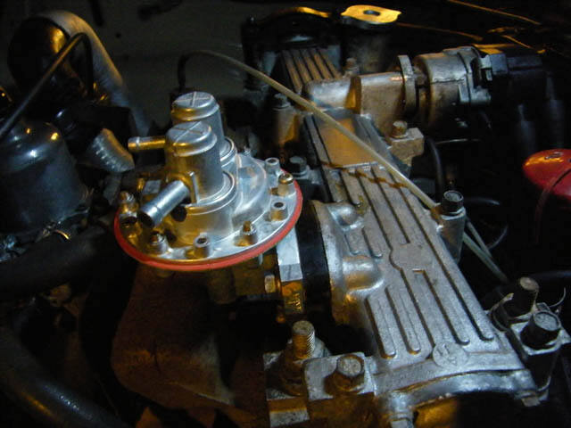

The poor repair to the waxstat housing would be an issue that would continue to plague my ownership of this car. British Leyland did not use very good quality material for this particular component and they are prone to dissolving or just having chunks fall off.

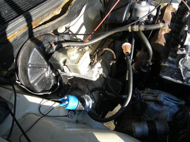

The other issue is that a previous owner had fitted an electric fuel pump to the inner wing since the original in-tank pump had failed. This pump was not really up to the task, and it was noisy, and it had no suppression so caused interference with the radio. Added to all that is that it just looked really ugly. The wiring wasn't that great either.
Here she is moving more things for other people and finding weird cars.

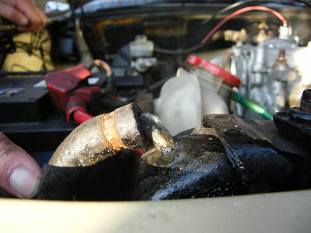

All was well until the following day when on starting the car there was quite a loud backfire sort of a bang. Turned out one of the fuel hoses to the carburettor had burst.
That made an immediate check of the other hoses necessary and highlighted that the clamp for the radiator overflow was missing and under certain circumstances, leaking.
Regular use of a car will always highlight problems that have been ignored and it seems common for owners of cars that go out infrequently to do the barest minimum to get the car to function. I was using the car as a modern car, trundling around town and going up and down the motorway on a regular basis, and that's what was highlighting a lot of the failing components. One issue I had on the motorway was when in the outside lane I suddenly lost power, thankfully I had the time and space to move over to the inside lane and the car picked up again and seemed okay. I pulled over at the next services and could find nothing amiss so carefully made my way to my destination.
It turned out that the electric fuel pump couldn't keep up with the load that the engine demanded at 70mph, no fuel means no power, until you slow down and the load is such that the pump can keep up again. At this point, I didn't know that the in-tank pump could be replaced with a Rover SD1 item so instead we opted for a mechanical pump as fitted to Morris Marinas and other O-series equipped cars. It bolts straight on where there's a blanking plate on the Princess and it meant I could get rid of the electric pump and its wiring.
Looks like the pump was fitted in the wrong place anyway? These pumps work far better as pushers, rather than pullers. May not have had a supply issue if the pump had been mounted near to the tank?
I'd be on the look-out for the dreaded hot-starting issues with the mechanical pump? Today's petrol is a vastly different beast to that of the 70's and 80's...and earlier. [one reason for in-tank electric pumps being fitted??]
