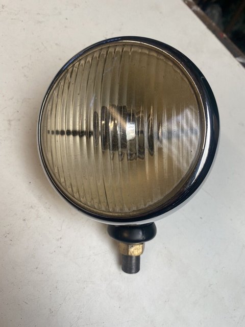

Does anyone know how I can date Lucas fog lamps, please?
I have an early type SFT 462 with a later glass. I would like to establish - if possible - when the later glass & reflector replaced the earlier version.
As my car is 1949 it may be that the earlier glass (that smashed) was incorrect for the year anyway.
It is just something that has bugged me for ages. Confused

This shot shows how the earlier version of the SFT 462 has a stepped reflector and no cross hatching in the lens.
This is clearly different from the later version (thanks Dave) which eschews the stepped reflector and has cross hatching .
When I got the TC it had the wrong (Raydot) fog lamp so I bought an SFT 462 fog lamp which I subsequently restored.
Sadly, in a freak garage accident (some time ago) my original lens was smashed. I have found a replacement SFT 462 lens like the one Dave has posted but the earlier ones (as above) are more scarce.
What I don't know - and would like to establish - is exactly WHEN did Lucas make the change. If the date is before 1949 ( or Chassis 10,030) I can fit the replacement lens and 'non - stepped' reflector to the restored lamp as they are the same size.

The catalogue that shows the Blocked lens is dated 1953, my next earlier catalogue is 1939 and that shows lists the Lucas ST27 Foglamp for the early TC. The ST27 has a separate lens (fluted) whereas the SFT462 has a combined reflector & lens light unit, is it possible that you had ST27 innards in your SFT462? as they are both the same size, did the lens that got damaged have a separate reflector ?
Posts: 7419
PostPosted: Mon Mar 13, 2023 2:42 pm    Post subject: Reply with quote
Dave. I am also mystified by the catalogue listing. I know that up to TC5000 the FT 27 was fitted. From then on - and into the TD - SFT 462 was fitted.
There were definitely two versions; the first having the stepped reflector (which I still have) with vertical flutes in the glass (that broke) and the type that you posted (which I also have).
What I want to know is which one would have been fitted to TC 10,030 on 25/10/ 1949.
If the change was made prior to my car I am sorted. If not, then I am looking for an early type lens.

I still need to establish when the switch over was made. It is known in MG circles that there were early and late versions fitted to the midgets but to date I have not found out if that means TC AND TD. My guess is the later one is what would be found on my car - in which case I have the lens and reflector. They will fit the earlier SFT 462 shell.
If I need the earlier glass, however, they are particularly scarce. Unfortunately, the FT27 lens is 5 1/16". whereas the SFT 462 is only 4 1/2"
Anders Clausager - in his book 'Original MG T series - states that FT27 was replaced by SFT 462 in 1948; from TC 4739 on. Unfortunately he doesn't stipulate when the change from the stepped reflector was made.
Sherrell, in his comprehensive book "TCs forever" is likewise not forthcoming with this little nugget of information.
